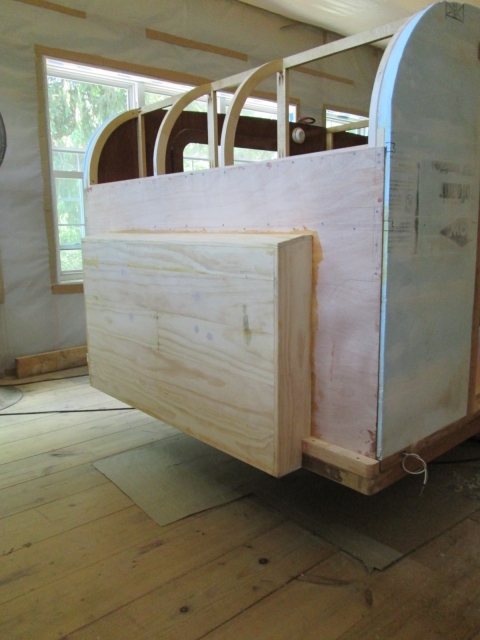

Those of you who have been following my build might remember this picture of me "training" a sheet of ply to skin my hatch with:
Some time after I took this picture, I did a pre-coat of wipe-on poly on the inside side of that sheet. Time passed, the sheet got set aside and forgotten until yesterday, when I got started on skinning my hatch. The ply definitely bends better the "other" way now. IIRC, I let the sheet be flat while the poly cured.
I'm not sure what the lesson here is. Either the trick is to poly the other side from the bend. or let the poly cure while the ply is bent. Or both. :NC
Hope this helps.
