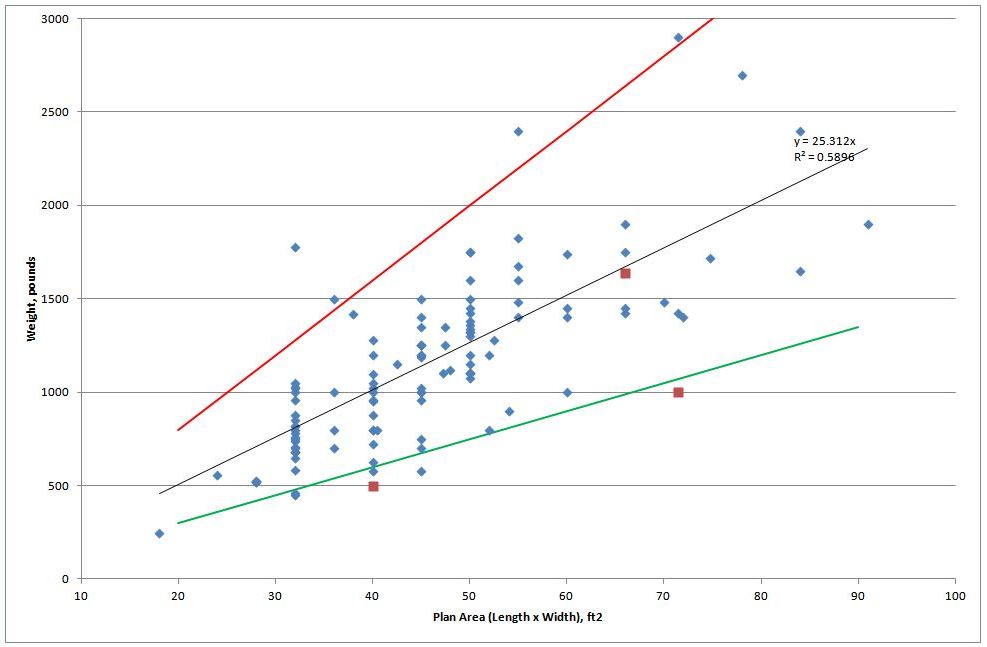

Sharon Heisley has done a magnificent job in cataloguing over a hundred teardrop weights and this has given the opportunity to reverse the process and say what does a typical teardrop weigh?
The data is shown in the graph below, for those that read graphs - weight up the vertical scale and plan area (body length times body width, both in feet) on the horizontal axis. The red squares are foamies, I believe, which shows they can be the lightest trailers. The biggest thing to notice is the huge range of weights at each size. This gives the most important conclusion - the weight of a trailer depends a lot on how heavily it is built. That sounds obvious, but it is important to recognise that when someone asks "how much does a 4x8 Benroy weigh?", there is not a single right answer, just a huge range of right answers.
Sharon trailer weight graph.JPG (59.27 KiB) Viewed 34471 times
Excel worked out the black average line thorough the middle and I've added the red 'Heavy' and green 'Light' lines by eye. These can be turned round into simple formulas for estimating trailer weight, as follows:
Light - Trailer weight (pounds) = 15 x Body Length (feet) x Body Width (feet)
Average - Trailer weight (pounds) = 25 x Body Length (feet) x Body Width (feet)
Heavy - Trailer weight (pounds) = 40 x Body Length (feet) x Body Width (feet)
And, yes, that means the heavy trailers are nearly three times the weight of the light trailers for any given size! That's why there isn't any one 'right' answer to what will/should my trailer weigh? You need to calibrate your own behaviour first. If you design aircraft structures for a living, you can probably build at the 'light' weight. If you don't believe plywood is made in any thickness but 3/4", you will probably build at the 'heavy' weight

Re: Estimating your teardrop weight
Postby citylights » Sun Jul 13, 2014 8:30 am
Excellent! Love to see statistics in use.
The variability of teardrop weight is not entirely dependent on the construction. It is greatly dependent on options too. An air conditioner, mini-fridge, built in stove, 15-inch tires, and battery will take a light weight teardrop right up to the heavyweight line. The difference is only a couple hundred pounds.

I'll call the formula "good by me". My TTT is most definitely not a teardrop. It's a 4'x7' box for sleeping only.
By this math, it should weigh about 420lbs. Because I used an old PWC trailer, my weight is a bit higher, at 470lbs. I'll call that fair.

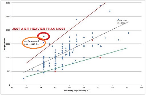

If the weight of "heavy" trailers are usually near the median described by this formula Heavy - Trailer weight (pounds) = 40 x Body Length (feet) x Body Width (feet)
then my build is in its own category, the Neutron Star-Class-Trailer weight (pounds) = 55.5 x Body Length (feet) x Body Width (feet). Not only did I use 3/4" plywood in my build,
angib wrote: If you don't believe plywood is made in any thickness but 3/4", you will probably build at the 'heavy' weight
but incorporated neutronium wherever I could, to ensure that it would grip the road. EDIT 10-26-14:Weight reduction program still in progress. Now weighing in at only 1518 lbs, just 47.44 x body length x body width.

Please recognize that the weights are not a formula but rather the highs, lows, and average weights volunteered by our forum members.
What your teardrop will weigh is mostly dependent upon you and how you build yours and, yes, that includes the weight of your chassis as well as your cabin.
