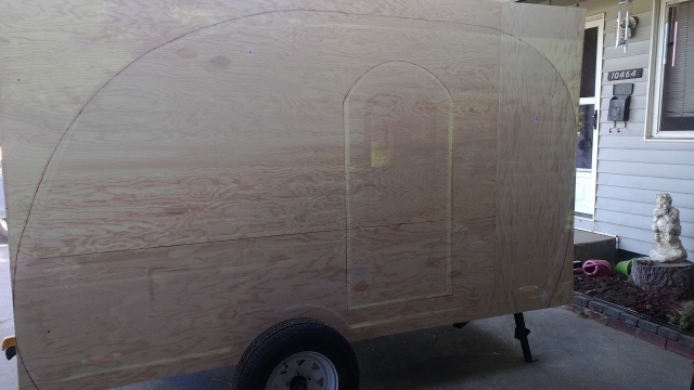

If you don't want to go down the transparency route, you could import your graphic into PowerPoint, and if you can borrow an LCD projector from work, use that to project the image.
This is exactly what I did:
10x6 sheet of ply with a picture of WoodButchers 'Club Car' projected on it as a sketching template.
Have Fun!!!

Postby mallymal » Mon Jul 21, 2014 4:13 pm
That's great to know that if I ever try out my idea, I know someone else has already proved it works. :thumbsup:
