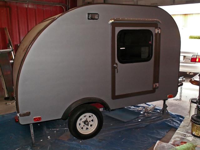

Postby Toytaco2 » Tue Jul 29, 2014 9:38 pm
Yes! Usually the RV places sell trim in "plain" aluminum finish or already painted white. I used white standard insert molding style trim. The pre-painted white finish will work as an excellent "pre-primed" trim. Just hit the surfaces with fine grit sand paper and then paint it the color you like. I did this with mine and finished the trim with "hammered" Rustoleum paint. There's been no flaking or chipping of the paint at all. The hatch latches were painted the same way. My son, a professional painter sprayed the trim with an HVLP unit before it was installed, but I think the same paint in a rattle can applied carefully would be just as good.
