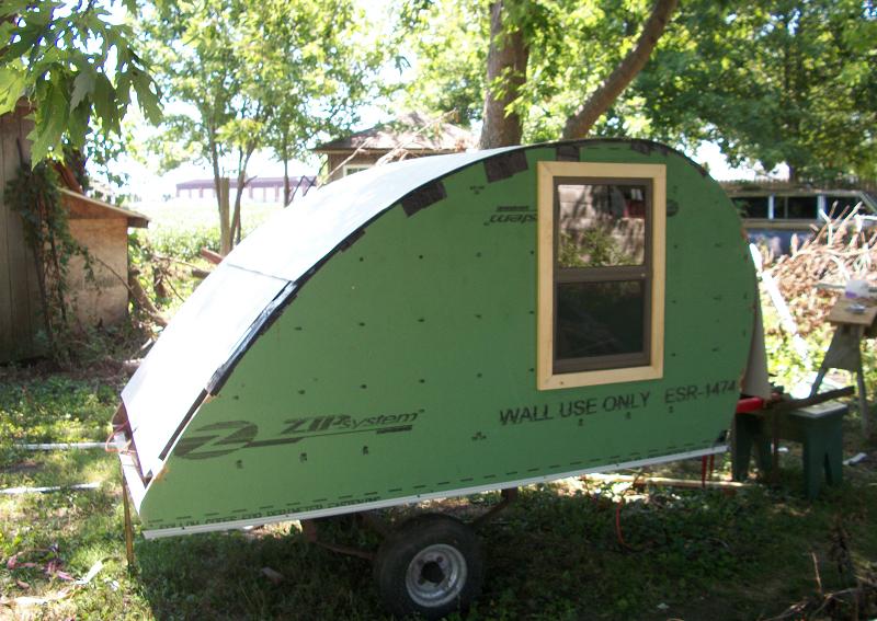

Re: Has anybody ever used OSB for sidewalls??
Postby bobhenry » Fri Aug 22, 2014 6:28 am
Eggbert was 7/16 osb Image
Chubby is 5/8 osb sub siding Image
Rip van winkle is 7/16 zip wall a fiberglass faced osb protected by FRP Image
The chuckwagon is 7/16 zip wall also with the same FRP outer skin.Image
They are all still viable after 7+ years.
Hell the caboose is 7/16 zip wall covered with only 2 coats of tractor enamel paint It has been in the weather 26 months and shows no sign of any distress.
Some of us poor folk just cant afford the 72 layer oak faced marine plywood at a gazillion dollars a sheet.
