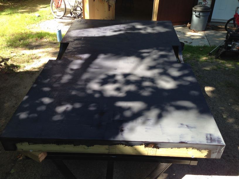

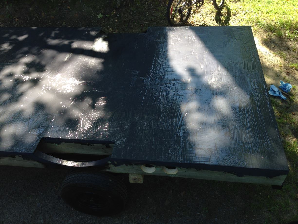

Postby MJS613 » Tue Oct 28, 2014 8:38 am
I ended up using the following stuff:
http://www.lowes.ca/roof-coatings/black ... 96637.html
It seems to have done a pretty good job, I decided to put on 2 coats and I still have a ton left, been pondering on putting maybe a 3rd coat on before it gets too cold out here. I don't have any pics of after the second coat yet but I will upload once I get them. This stuff dried almost like a rubber coating seems to stick pretty good and seems like it will be pretty durable.
This is after 1 coat
After fisrt coat of sealant.2.jpg (71.52 KiB) Viewed 767 times
After the first coat
After fisrt coat of sealant2.2jpg.jpg (178.23 KiB) Viewed 767 times
