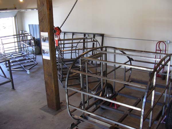

Check out alaska teardrop's stuff.

Postby corncountry » Tue Aug 26, 2014 4:57 pm
Another steel frame tear. This is my steel frame build. viewtopic.php?f=50&t=34013
I used 1" by 16 gage sq. tubing. The skin is .040 aluminum held to the frame with VHB tape. The inside paneling is also held with the same tape.
It is 5 ft. by 9 1/2 feet. Without all the camping stuf loaded it weighs 930 lbs.
Have fun with what ever you build
