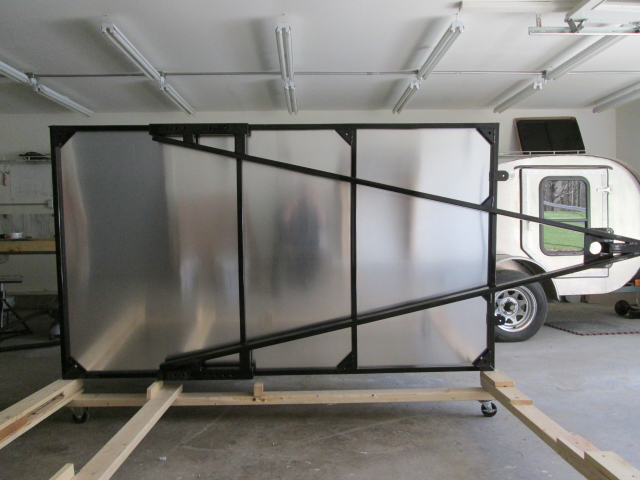

Attach a .050" or .063" sheet of aluminum to the topside of trailer frame. Build walls. Lay a full sheet of 1", 1-1/2" or 2" extruded polystyrene insulation on top of the aluminum. Lay a thin lightweight flooring on top of the insulation.
ImageUnderside protected. Waterproof. Total floor insulation with no thermal bridges. Significant weight savings. Will not absorb moister & rot. Simplicity of construction.
IMO, most mattresses have very little true insulation value & will absorb interior moisture when laid on a cold floor, especially open cell foam.
Fred
