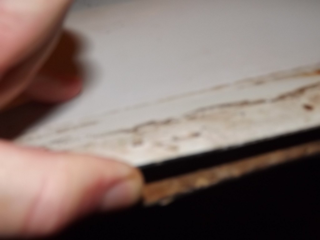

Anyway, turns out that there was a leak around a screw that went through the top filon piece which finally did enough damage that I saw it so I'm trying to repair the dry and make sure that I don't have new leaks. I'll be replacing the rotted wood and reattaching the hatch and would like to ensure the best seal.

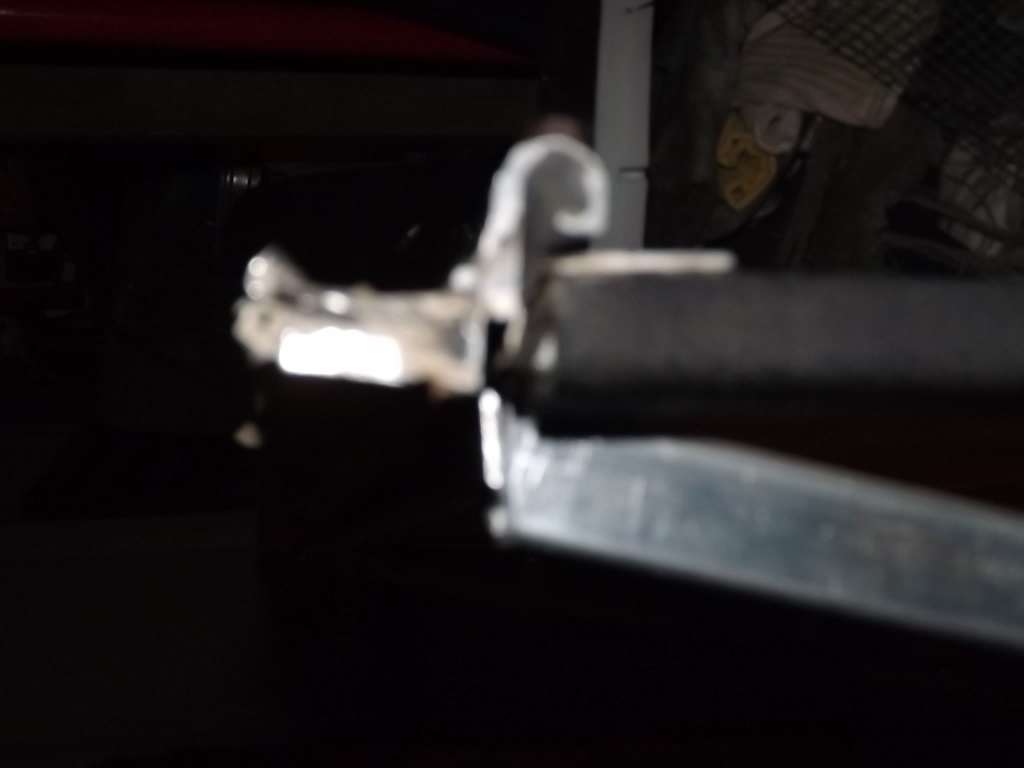

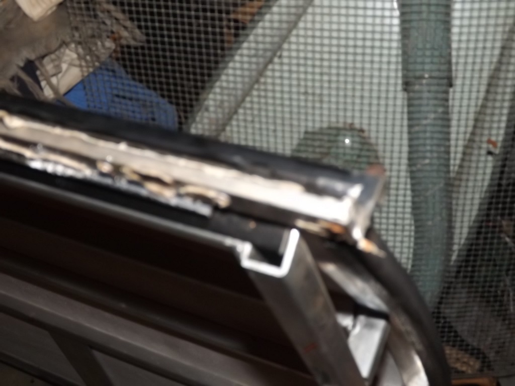

THe LIttle Guy of this era's top is made with a 2x4 frame with a layer of what we used to call Masonite (pressed fiber board) and then a layer of Filon on top. The hinge (as shown in the pictures) is the black aluminum hinge and mounting flange. From outside in, there is the hinge flange (black in the picture), a layer of butyl tape, a piece of aluminum bar stock (silver in the picture) and then another layer of butyl tape. Next in this sandwich is the filon, the masonite, another layer of butyl and the frame piece.
In reinstalling this, I'm wondering whether I would get a better seal if changed the order to this--> From outside in the hinge flange, a layer of butyl tape, the filon, butyl, the piece of aluminum bar stock, butyl tape. masonite, another layer of butyl and the frame piece.
Your guidance including better ideas would be greatly appreciated.

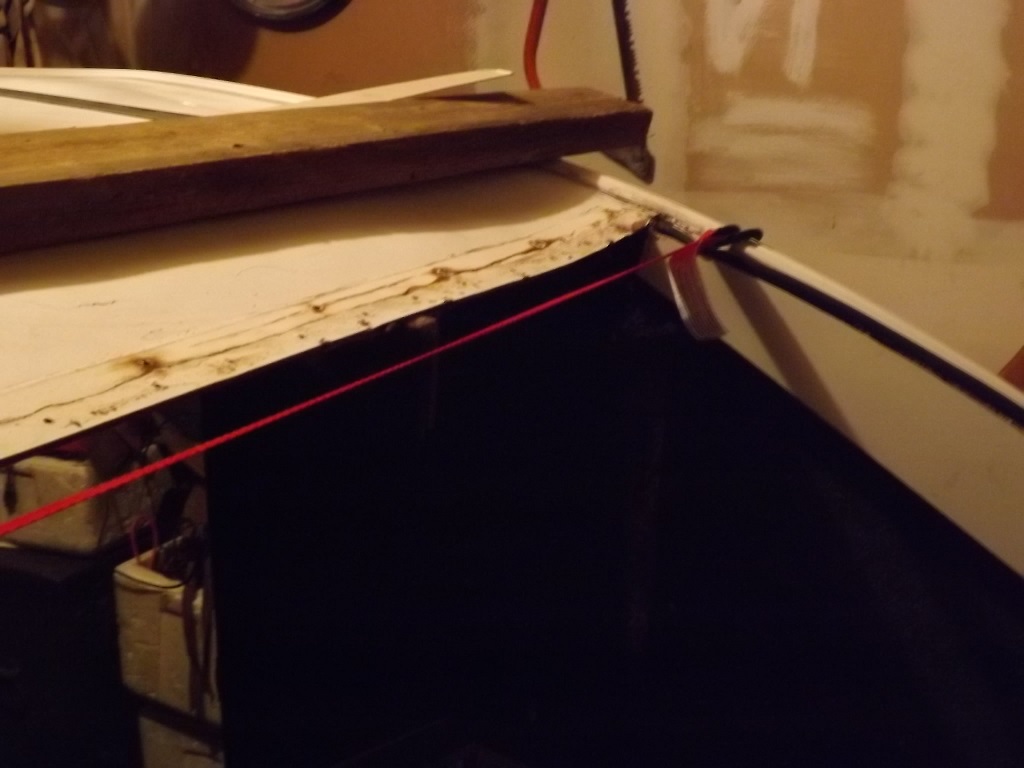

One more picture that may help visualize
~Keith

Postby RKH » Thu Sep 11, 2014 9:08 pm
You may have the reason correctly, Tom.
The Little Guy of that era had the rear hatch setting above the roof line, not inset into a notch like most of the custom/homebuilts. (I've got the hatch off right now so can't get a picture.)
The hinge then may have set on top of the barstock and on top of the Filon roof to help make up some of the thickness of the hatch panel itself.
The actual leak developed where a piece of trim was added in front of the hinge at a 45* angle, rather than flat across the roof, probably to help even out that joint. By not being installed flat, the butyl on the back of the trim didn't seal but created a pocket where water could pool and eventually leak down through the screw hole.
With all that said, I believe I will just leave the barstock off completely if I can make the transition from roofline to hatch fit without it.
