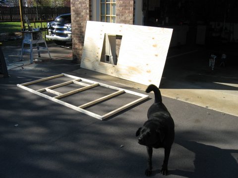

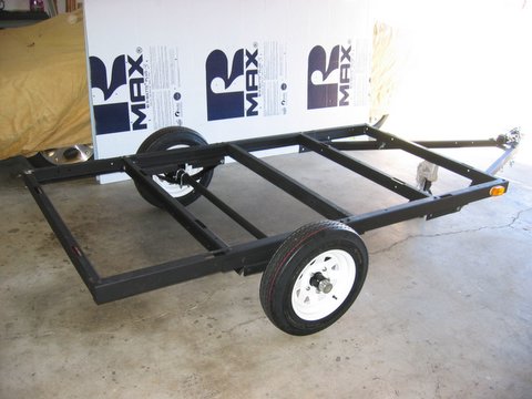

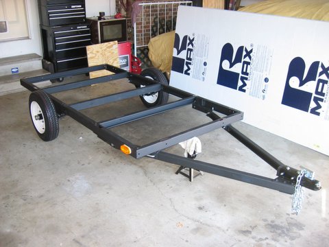

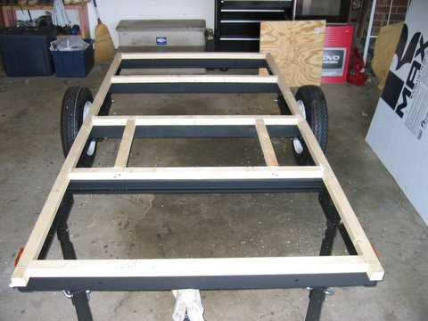

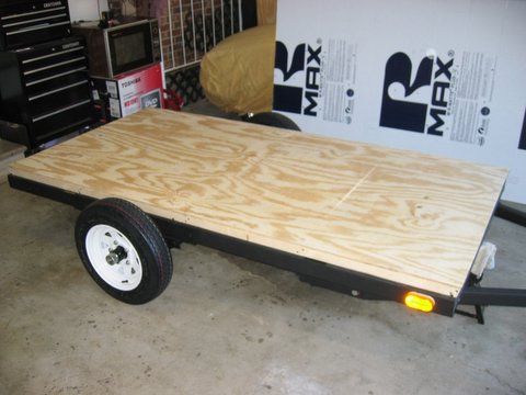

Hi to all, a new guy here looking for aluminum. I just got started this past weekend, but have visited this site often in the past getting ideas. Seems like it will be great winter project.
My ear got sore on the phone today trying to locate some aluminum. I am building a Kuffel Creek Cubby and live just outside of Nashville, TN (Smyrna).
As requested, here are a few pics.
Kevin stes in the material list that you should use .032 5052 H32. This is kind of greek to me other than the thickness. What other specs can be used or substituted? Any help would be appreciated.
Thanks, sid
