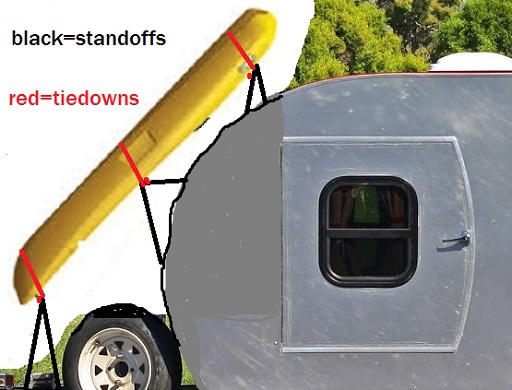

Visibility looking in your mirror
Stability issues at speed in high wind
Nothing to run into when the kayak is not on the trailer
Clearance where you store the trailer
Easy to load/unload, Doesn't interfere with the kitchen or the roof vent, and when the kayak is removed the door is still fully functional
Here's an idea: find or make hardpoints/stanchions to mount your kayak to the front of your trailer. It would solve all the aforementioned issues.

Yeah, it's like 14' long so mounting to the tongue diagonally would be scary, and a battery box is in the way there.
