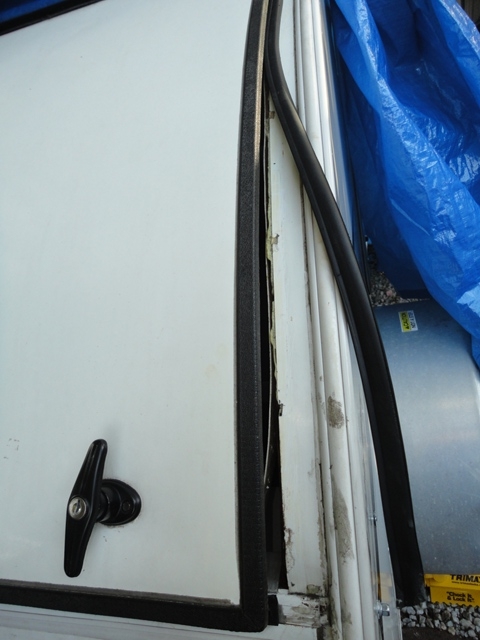

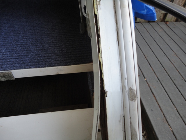

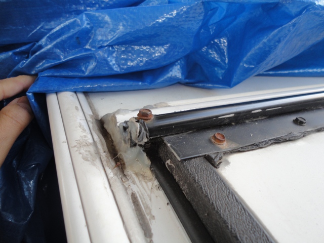

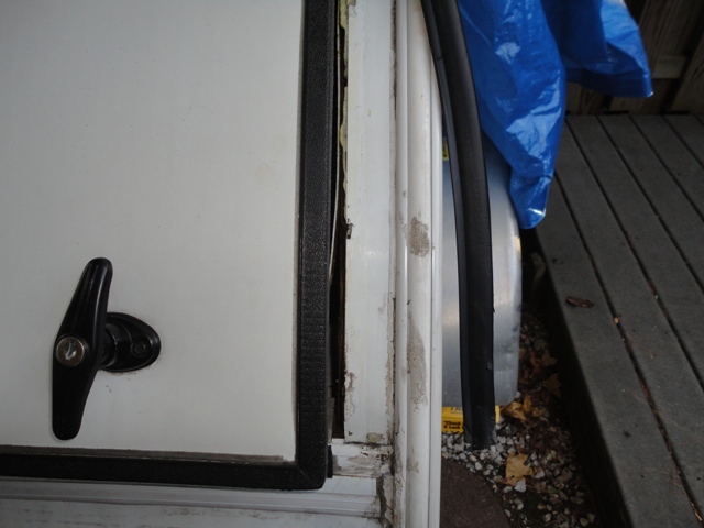

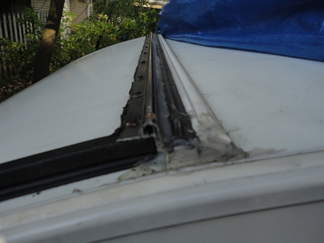

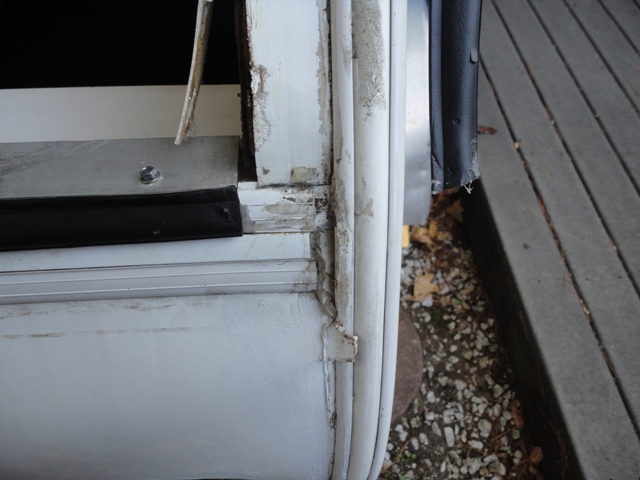

Hi All, i just got back the trailer from shop couple days ago. And i discovered the gallery lid doesn't closed properly. It has a gap on the lower right hand side. So i think it may be some loosing screw of the hurricane hitch. But it seems fine to me, so i end up remove a screw from the right side of the hurricane hitch in order to move over the lid a little bit. So it could closed the lid completely. Enclosed some pictures for my trailer, please give me some suggestions to fix this problem. Thanks! :(

In photo # 4 it appears to have been hit or pushed in, at least that's what the picture looks like, and of course I'm not there to look at the whole shabang, so I could be 180 out. :thinking:

Hi All, Sorry for the confusion. The shop replaced my hub and repaint the axles only. But i saw this problem 2 days later. Not sure why it happens, it seems like the side panel of the lower right rear trailer pulling out a little bit. But i don't see anything underneath. I don't know how to fix it. :( .

Being the proud owner of a 2006 five wide platform Little Guy, I have noticed the posts concerning the separation of the sidewalls of earlier year Little Guys. The weak point, as I understand it, is the connection to the floor at the sidewalls. Mine has been garaged continuously since new and has experienced wet conditions only under the hose during washing. It does not have a lot of use and has been used gently. It is as sound as the day it was built. I am not sure if the problems noted in various forums are from a design weakness, leakage of water during storage, or seepage during use in rainy weather. My impression of your probnem is that it does seem to be the common problem cropping up again with these early trailers. I think you should remove your right fender and all the trim on the right side of the hatch and hinge area. Try first to see if that right lower corner has separated from the floor connection. If it has, it will explain why your hatch is not fitting properly and you can begin the fix by solving the attachment problem and putting that right sidewall back in position. Let us know how this progresses.
