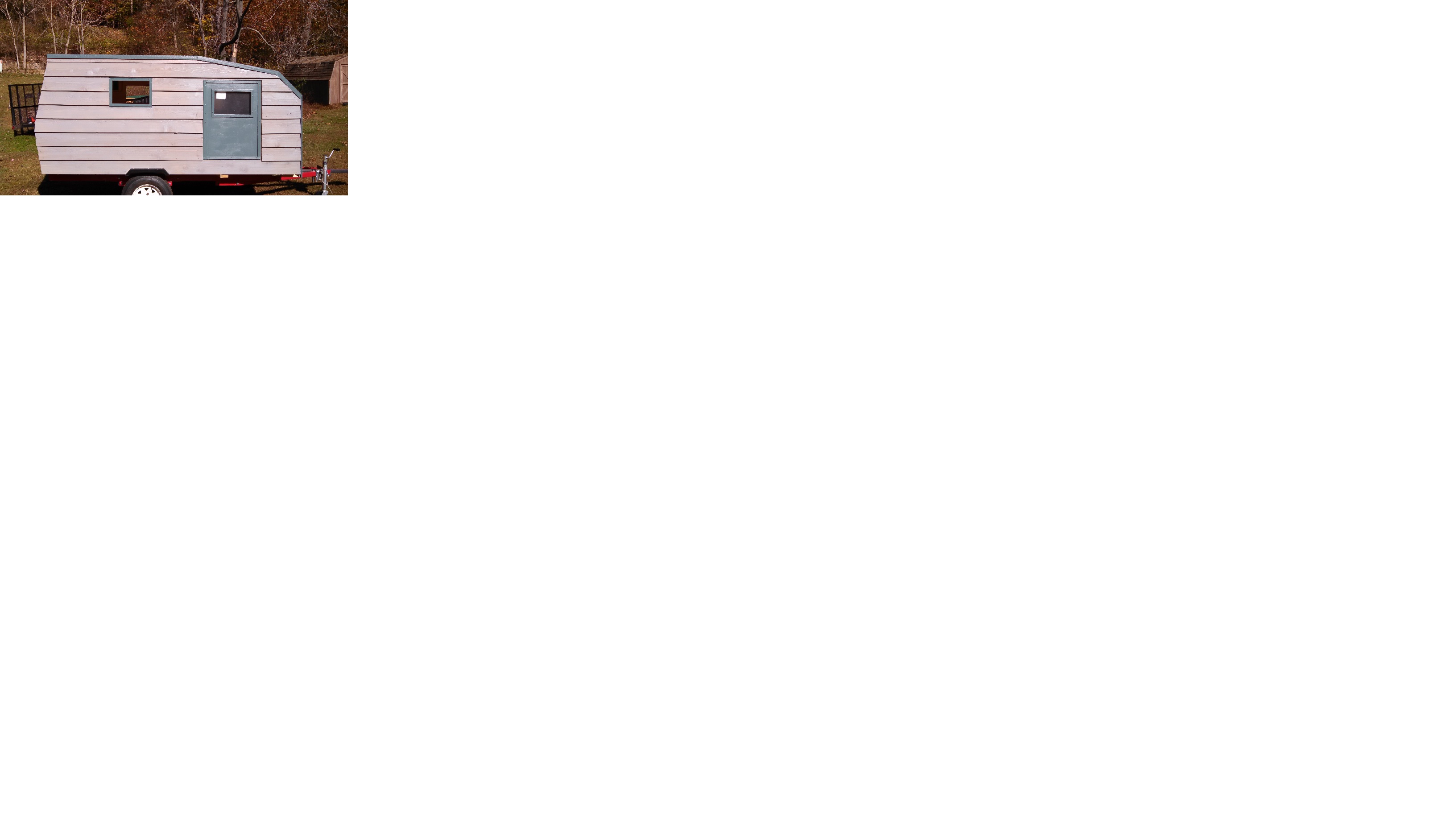

I want to add a kayak rack to the top of my TTT. My side walls are 3/4" ply, the roof, front and back are 1/2" ply and I have 2 x 2 spars at every angle in the roof. Is there any reason I couldn't/shouldn't just use two 2 x 3's over top two of the spars for a simple and inexpensive rack to haul a 46 lb. kayak?
Pic of profile

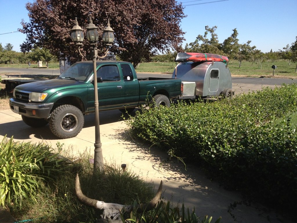

I mounted mine to the 3/4" ply sides with 3/16" steel plates welded to some 1" round pipe and it supports my 75# 14' long Jackson kayak just fine. Could maybe even fit a second one up there.

Two 2X3's should work fine with the way you built things. It sounds good & strong. You could also go to a slightly bigger stock (2x4 maybe?) and cut a profile to let the kayak rest and "nest" in a small depression in the top edge. A little carpet for a liner for wear, a couple of eye bolts run up from the bottom of the 2X (counter-bore the nuts & washers from the bottom side), to straddle the hull & you're good to go. If you wanted to get fancy, some spar varnish to completely seal the wood first, a nice sanding, and it would look really nice once it's installed. With a bungie cord or two it would be fine for a short trip, but something a little bit more positive might be better to hold it in place on longer trips. Can you place the 2X's for a good attachment on the spars below? tim
