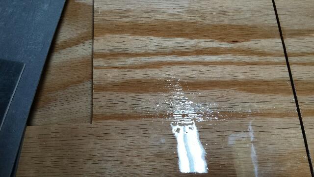

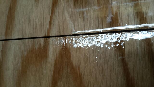

Postby Graniterich » Thu Nov 13, 2014 9:33 pm
Pictures

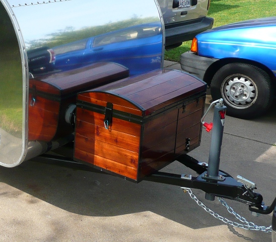

On my tongue box, the exterior cedar was tinted with TransTint dyes, followed by 3 coats of Raka expoxy, and the 3 coats of Emtech EM9300 urethane finish from Target Coatings. (I shot the Emtech EM9300 with a cheap HVLP spray gun made by Wagner.)
Because I had the time, I sanded between the epoxy coats. Even with sanding, as you can see in the above picture, the epoxy surface was not glass smooth and these imperfections can be seen through the urethane top coats.

Postby doug hodder » Sun Nov 16, 2014 7:11 am
I'm sure others may not agree with me on this, but it appears to me that you have some sort of contamination on that upper edge just below the cut. The epoxy looks like it fisheyed to me. May take some time to get it squared away. Doug
