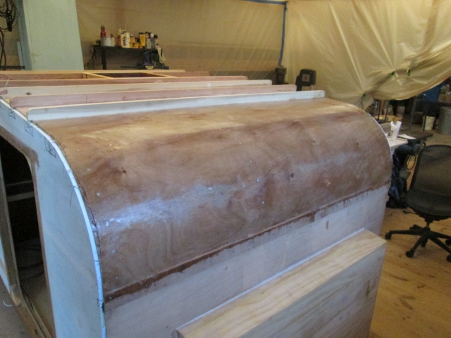

Postby KCStudly » Mon Dec 29, 2014 10:12 am
Wobbly Wheels wrote:Even a rank amateur can get a decent finish on a small part.
Speaking from the perspective of an epoxy and glass weave rank amateur, I can second this statement. The first part I ever made was a small speaker pod for the kick panel of my old P/U truck. Not pretty, but came out okay, and could have been nicer if I had taken more time on it. The second thing I ever did of note was to cover the front radius of TPCE, and that came out pretty good, if 'n I do say so myself.
