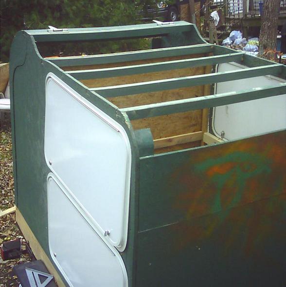

I've found one supplier for Hurricane hinges in Canada but it's a bit more than I want to spend on one. Getting one across the border is out as well, so I'm left with either forking out for the right stuff or getting a stainless piano hinge through my marine wholesaler (boatbuilder and marine tech by trade). Don't get me wrong, I have no problem if its the only thing that works...but I don't think it is:
The piano hinge I'm looking at is 3" wide and made from .060 (IIRC) 304. I'll have a strip of thin belting over the outside of the hinge and screwed in via the same fasteners so leakage shouldn't be a problem. I'll also have room on the spar below the hinge to rabbet for a seal if need to. Any thoughts/problems/concerns spring to mind with this arrangement ?

Water can leak around the fasteners through the belting.
The puckered material, when the hatch is closed, will have to "go" somewhere.
Will there be a recess?
If so, where will the water go that collects in the recess?
Using fabric or rubber with a piano hinge will work, but it works much better on top of the hinge.
The biggest consideration is sealing all the penetrations.screw holes, and letting a bit of hinge hang over the sides to direct water from abouve the hinge to exit over the side, instead of following the hinge and going inside.

I will be using a piano hinge and rubber strip in an effort to streamline the looks at the wall to roof join, but all the same here is what I have gathered.
You want to make sure to use EPDM rubber due to its UV resistance and outdoor rating. Pond liner material is one option. I wanted to buy to my exact spec (size and material) so ordered some rolled strip from a rubber sheet goods supplier. The cost of the strip and hinge ended up being about the same as a hurricane hinge.
The rubber should go on the outside to keep water and debris from settling in under the hinge. The excess rubber material can then bulge up, acting like a rain diverter.
Screws shot thru the rubber do not provide stable clamping for the hinge, so it is better to attach the hinge first then add the rubber retained by additional trim strips, such as flat bar aluminum.
I plan on drilling additional screw holes in my hinge leaves for the trim screws. That way there will be a full complement of screws securing the hinge structurally, and the added trim screws only need to compress the rubber enough to bed the sealant used.
Because I want a rounded transition from roof to wall (3/4 inch radius) with nothing jutting out, the hinge will stop short of the radius, but the rubber and forward trim piece will continue to wrap down the side wall an inch or so. The rear trim will stop short of the radius with the hinge, hopefully allowing the small portion of rubber flap there to flex enough when the hatch is open, but still creating enough of a diversion for runoff and keeping it from curling back into the galley.
Yet to be seen, but that is the plan.

I'll be using lots of SikaFlex (LOT291) to bed all of the exterior fittings. I spent a lot of time building boats for a living and, if there's one thing you remember, it's that you can never use too much sealant ! With the material wrapped over the hinge when closed, I don't see the 'puckered area' you're talking about. I figure it should have enough flexibility to deflect out of the way when open (second pic). I thought about laying the rubber flat and using a couple strips of aluminum to clamp it (with sealant as well) but figured this would be an aesthetically 'cleaner' installation. That said, it sounds like putting on the flat is the way to go.

Ok, so it seems the take-away here is to lay the rubber flat and get a good clamp with some strips of aluminum a la Bob's pic, making sure everything is well bedded and piano hinge ought to be fine.

Yeah, I'm going to lay my hinge flat on top. I figure it to be about the only way to make sure that the hatch is squared up while doing the install. Now that my hatch is mostly built and the gap between the spars moved a little wider at one end, I'm glad I planned it this way; the hinge won't care if it is 1/4 inch gap at one end and 5/16 at the other.
