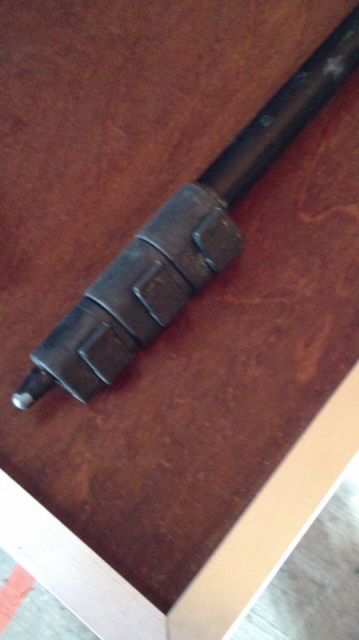

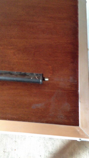

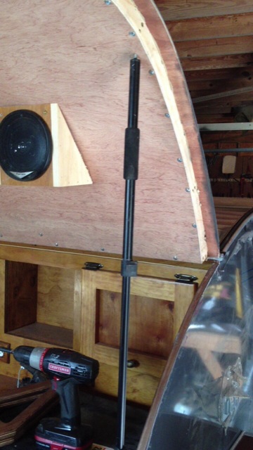

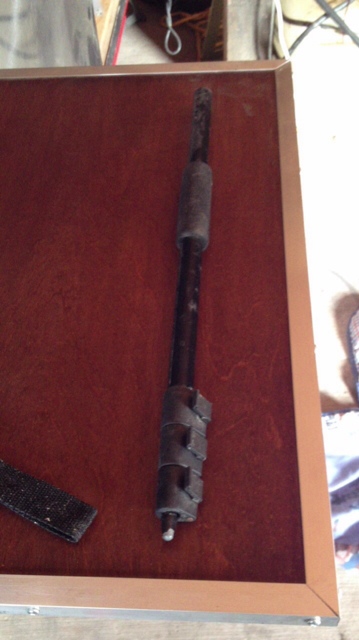

I was working on trailer a while ago and saw this and thought it could make a simple cheep hatch support
It is a telescopic shooting stick bought at Wally World unscrew top and you already have a threaded insert to attach top release cam locks to adjust length insert bottom into bracket and pin what do you think

looks like it might hold it up, depending on the weight of the hatch.
One thing you NEED to add is a strap to hold the hatch down.
Several hatches have caught a gust of wind and blown over the top of the tear springing the hinge. Not good.
A simple strap will prevent this,

The shooting stick has cam locks no need for strap I can't pull them apart and just one supports my hatch so weight isn't a problem even when fully extended they won't come apart some sort of stop built in keep them together when extended I can release cams close hatch then when I open hatch they extend all I have to do is push latch shut and it's secure best thing is no holes to try to line up one hand operation

So the ends of the shooting stick is on a swivel?
The stick Is always in place. Just has the length changed?
Shooting stick(pool?) is at the same as a extension paint pole?
Sounds like a good low cost support that will not fail when really cold like the struts tend to do.

Howdy, As Sam said, if a strong gust tries to lift your hatch, will the small threads be beefy enough to hold it or will they pull out? You could test it on a piece of scrap and see how much force is required to pull them free.
