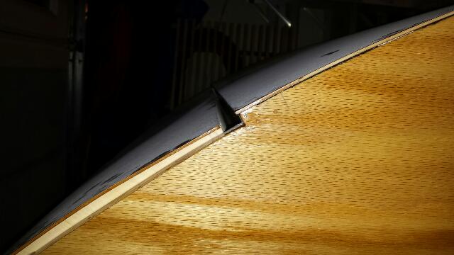

I used the wide lip RV insert molding on my hatch installed as Grant said with pop rivets. Here's a picture of the under side. (I added a strip of the same aluminum as I to the bottom of the hatch overhang. That's why you see aluminum on the bottom.)
Here's a picture from the outside before the insert strip is installed.
I never did get a photo with the insert strip. I'll see if I can take a picture in a couple of days.
