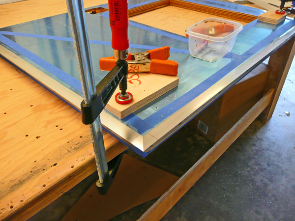

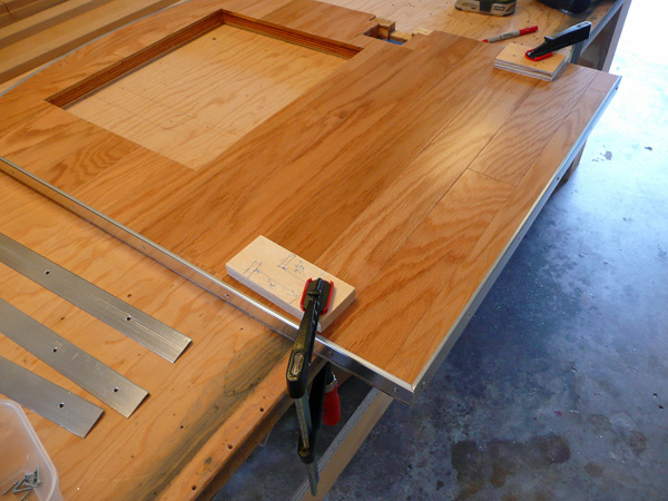

My doors/walls are 1-1/4" thick too. It took a lot of time, but I used two pieces of trim on my door. Here's a sketch of how I did the trim and door seals. (The outer seal on the t-molding worked so well that I never did the inner seal.)
First I applied a wall cap trim with the lip toward the inside of the door.
Then I applied the t-molding around the outside edge. (I did round off the corners so I would not have sharp "points" at the corners).
A few other tips. If you use t-molding, you need to offset the plane of the door 1/8" or so out away from the plane of the sidewall to leave room for door seals. For the type of hinges I used, I added a 1/8" thick spacer on the wall side of the hinge. I used t-molding all around the door. If you do this, to keep the t-molding from binding on the hinge side, you need to use hinges where the hinge point is offset outside of the outer edge of the t-molding.

Thanks Tom, Your write up with the pics is very much appreciated. It is exactly what I was looking for. Where did you source your hinges from?
