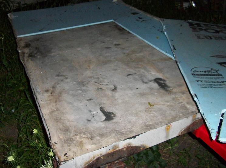

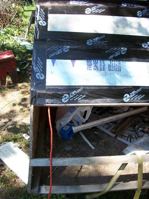

I insulated Chubby , the barn, Rip Van Winkle, The caboose, and the house in the house all with blue foam. I pre cut them on the table saw with little mess and the odd duck sized cavities were cut with a sharp handy knife and a straight edge.
