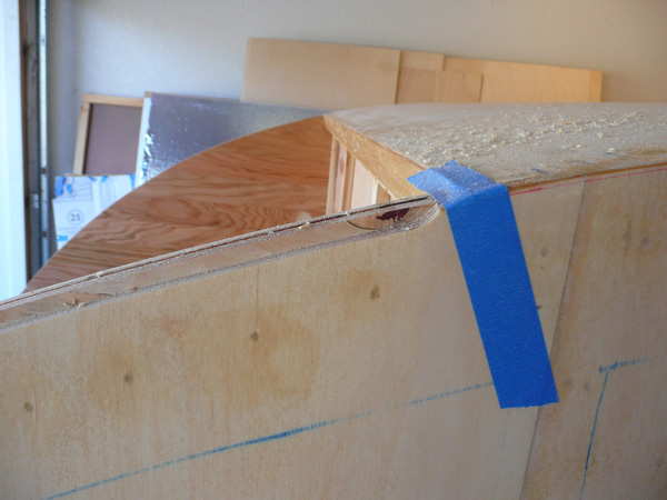

This forum has been promoting the 3/8" galley wall drop for years and it seems to work for me.
Grant I don't do it in the manner you described.
I always put two layers of 1/8" plywood on the roof, no matter what others feel, it's just my preference.
I then bearing route with a rabbit bit half way into the galley wall.
I then finish up with a straight top bearing bit to obtain a 3/8" step on the galley walls.
With the lid temporarily attached to the roof and threshold (see photo) with 3/8" gap for your hurricane hinge and 1/4" at the threshold for your seal I end up with a shy 5/16" gap on the walls.
I then put plam (plastic laminate) on the raw routed edge to end up with a 1/4" gap.
So your saying I only need 1/8" to 3/16" gap?
I guess I can add another strip of plam to the inside edge of the lid where your seal goes or I can add 1/8" aluminum instead of the plam to the already routed galley walls.
I understand you're not suppose to crush the seal past a certain point (50% ?) as it will be less effective in sealing out water.
Since your galley seal is .400 or a bit over 3/8" thick I'd figure a minimum of a 3/16" ( more than 50% ) gap would be necessary and a 1/4" would be okay.
It's good this topic has come up while I can still make some changes.
Thanks, :D Danny

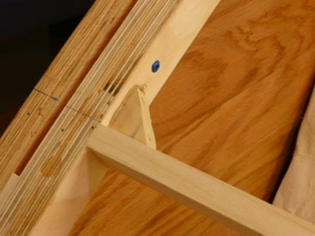

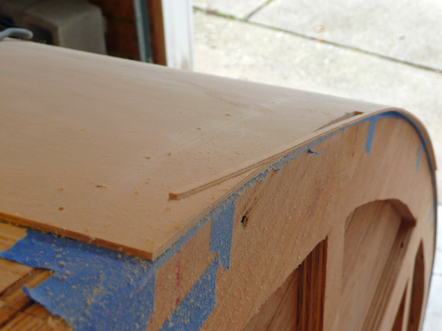

I did the same as Danny - cut the "notch" after the walls were in place and after I did my hatch framing. The reason I did this was because the outer profile of my hatch "ribs" matched the outer profile of the walls before the notch. This allowed me to frame the hatch in place referencing off of the outer wall profile.
Here's a close-up of the rib and wall before the notch.
Not notching the wall also allowed me to run the hatch skin "wild" and later be able to use a bottom bearing flush trim bit in the router to cut the hatch skin to width.

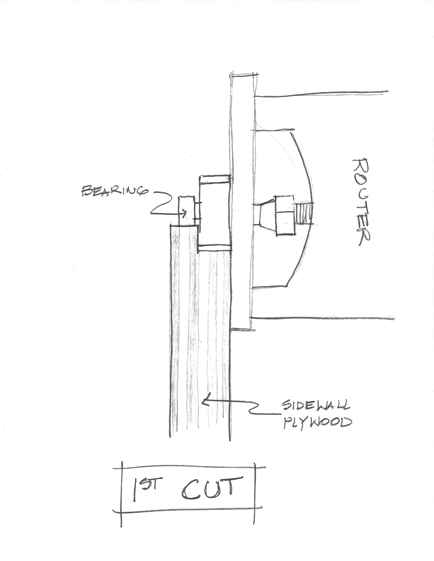

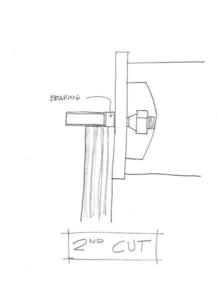

As Danny says, cutting the notch is pretty easy. It's done in two steps with a router. First cut a rabbet to the depth of the notch that you want.
Then finish the notch by using a flush trim bit with a bearing. It's easier if you use a top bearing bit so you can route from the outside of the trailer.
