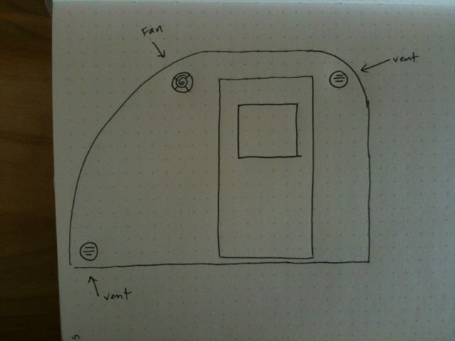

Postby mreidsma » Wed Feb 18, 2015 1:32 pm
Pete, that's good advice. Current thinking is to have a floor level vent near the back, with ceiling level vents at the front. In the middle, near the ceiling, I'll have the fan, like in this quick sketch:
I think the combination of passive and powered vents will be enough even when I don't have the windows open. But if not, I can always crack a few windows!
