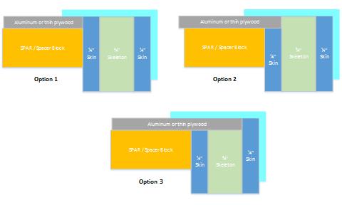

Where do builders bring the edge of their roof skin to? The attached image is not to scale and the bright blue corner is the edging.
I missed option 4. Bringing the roof Skin all the way to the edge?

I used option 4 - I used FRP for the roof material and it overlaps my 5mm Luan outside skin. It's been outside in hard, wind driven rain with no leaks to date.

All the way to the outside edge.

#4

Thanks, I'll go with #4.
