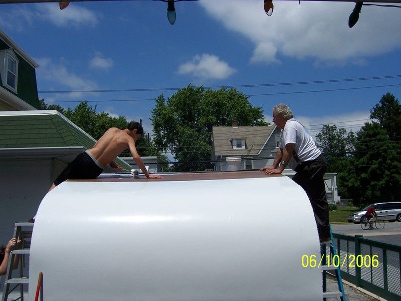

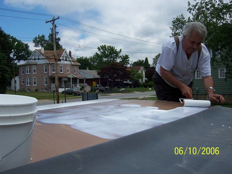

I use EPDM Rubber on Most of my Builds. I get it here.
http://www.ebay.com/itm/RV-RUBBER-ROOFI ... RL:US:1123
Definitely use the Latex Mastic. It drys a lot slower and gives you more time to work with the material so you have less chance of wrinkles and Bubbles.
Counter sink and Spackle the screws/staples etc.
And Don't put a sealer on the wood before you glue the rubber on. The rubber sticks better to the raw wood than to a sealer.
