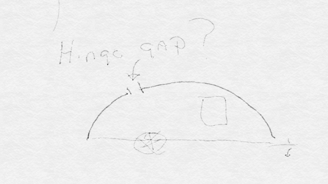

Postby Kaz » Mon Mar 23, 2015 7:52 pm
How much of a gap do you leave at the hatch bearing beam for the hurricane hinge ?129738

Re: Hurricane hinge gap
Postby Kaz » Tue Mar 24, 2015 6:27 pm
I guess I wasn't clear with my question. Question is when building your galley hatch and don't have the hurricane hinge in your possession : How much gap do you allow for at the top of the galley hatch between the galley header and the trailer header. How much space does the hurricane hinge require ?129816
Postby tony.latham » Tue Mar 24, 2015 6:46 pm
Kaz wrote:I guess I wasn't clear with my question. Question is when building your galley hatch and don't have the hurricane hinge in your possession : How much gap do you allow for at the top of the galley hatch between the galley header and the trailer header. How much space does the hurricane hinge require ?129816
I got it the first time. 3/8" Note the 3/8" spacer blocks taped in place:
Postby Kaz » Wed Mar 25, 2015 9:20 pm
Thanks , :thumbsup: now what about the sides and bottom. I've never done this before and only want to do it once. :thinking:
Postby Gage » Wed Mar 25, 2015 10:17 pm
If your going to use one of Grants hurricane hinges, don't worry about the gap. The hinge will establish the needed gap. Plan on a 4' hatch and locate your hinge board. Then with the hinge in place start your build of the hatch. Build it to and in the tear with 1/4" gap to each side between the side frames and the wall of the tear. Look at the hinge closely and you'll see that it not only attaches to the top of the hatch and hinge board but also buts up against both creating it own gap ;)
