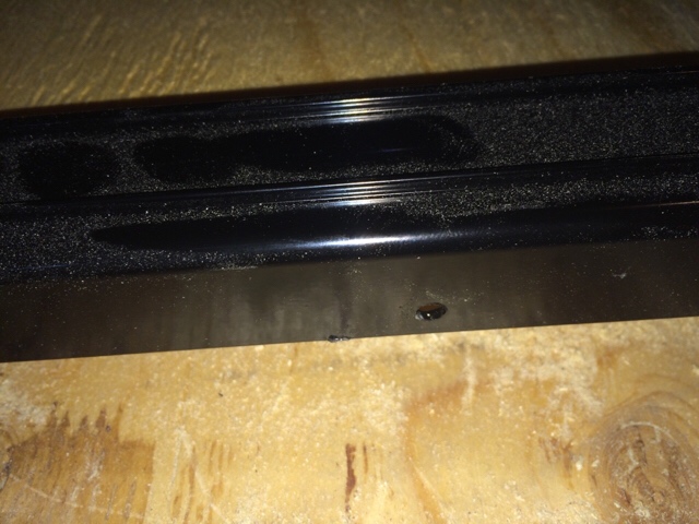

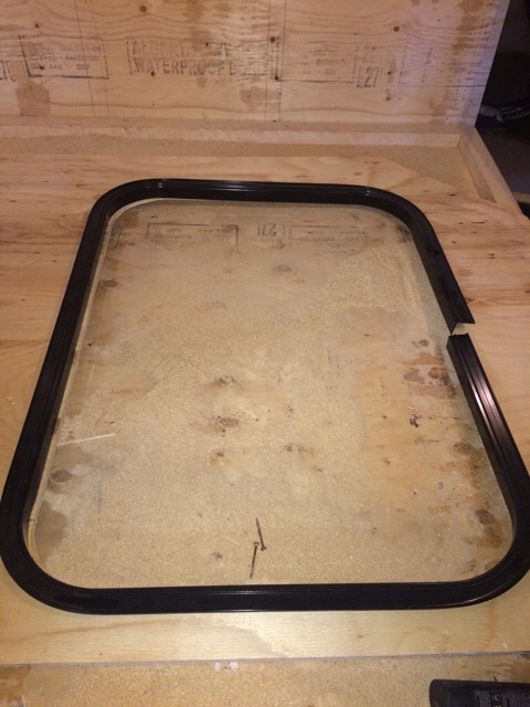

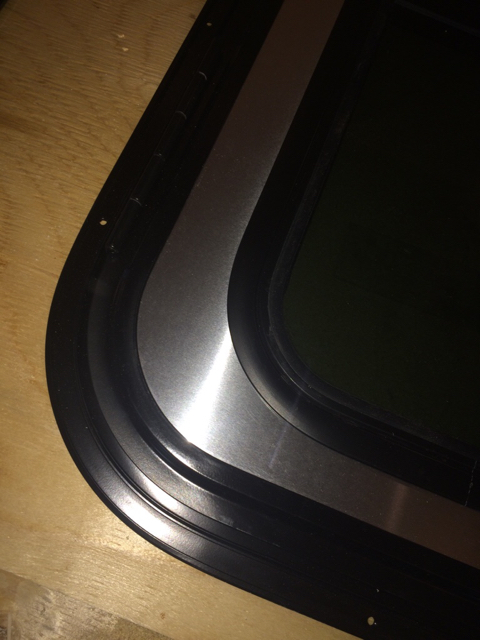

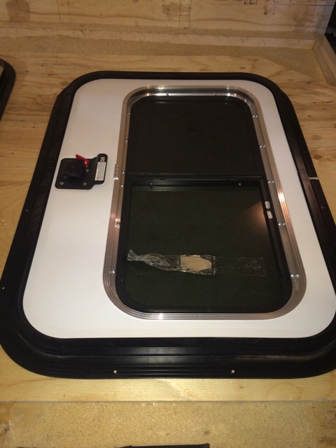

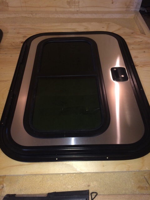

Postby jaydon44 » Wed Apr 01, 2015 7:45 pm
Front of door
Front of door close up
Back of door
Notice no "v-groove" or rubber seal
jaydon44
Posts: 14
Joined: Tue Jan 13, 2015 4:27 pm
Re: Vintage Technologies Door Help please
Postby jaydon44 » Wed Apr 01, 2015 7:47 pm
Not sure why these pics are posting out of order, kinda makes my descriptions under each on useless lol

Postby jaydon44 » Wed Apr 01, 2015 7:49 pm
Back of door close up and trim ring

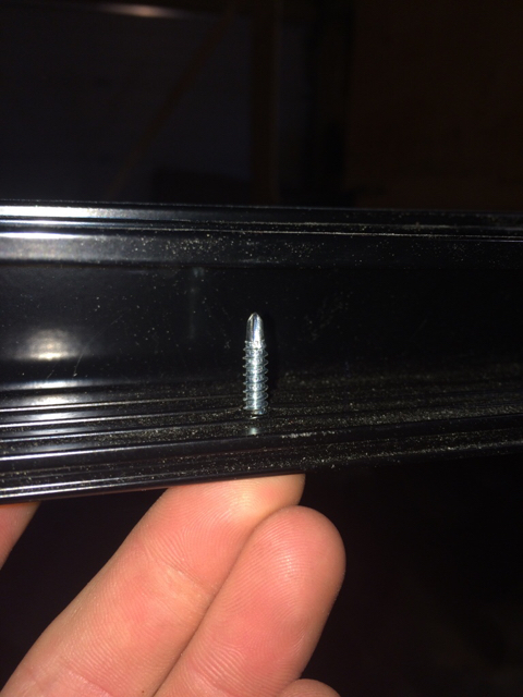

Postby jaydon44 » Wed Apr 01, 2015 7:54 pm
Screw going in from one of the exterior door holes.... Doesn't even reach...
Maybe if I slam my head inside the door a few times I'll figure it out

Update for anyone who runs into this, apparently for this door I got, the trim ring and the door frame do not screw into each other, u have to use butyl tape and screw the door into the wood of ur trailer from the outside, trim ring does the same from the inside but u drill/tap ur own holes and use the rubber flashing provided to cover screw heads
