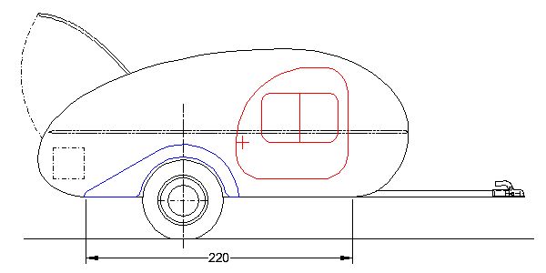

Postby angib » Sat Dec 17, 2005 9:35 am
Heikki,
218cm sounds perfect - the flat bottom of your trailer is 220cm long, so you have 1cm spare each end:
