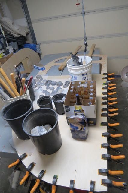

I've done it on three sets of walls using buckets of water and lead and beer. (Yeah, I've got buckets of lead and I used to have some beer.) :beer:
It works for me. One could easily win the vacuum bagging argument. I have my 1/4" pneumatic crown stapler locked and loaded and hit it where I feel it's needed while pushing down. I don't think I'd try it without my stapler. Not sure how far 14 cinder blocks will go. (I think I'd rather use water buckets, at least on the internal wall to protect it from getting scratched.)
By the way, those two portable 2 x 8 benches are worth their weight in gold. They sit on folding sawhorses. :thumbsup:

I used some scrap boards with plastic Milk jugs full of sand on top. The boards helped spread the weight around and acted like a larger clamp. I also used a few spring clamps on some of the edges. It seemed to work fine. Do a practice layout with the weights you have and see if you need more. If so scrounge up some books, jugs or buckets of water/sand etc. It should work fine

I have used welders, car batteries and wheels, buckets of water, beer, boxes of marking (ex teacher) all sorts of things...
the more the better, just use what you have.. if you have a spare sheet of ply to place on top to spread the weight.. even better

Second the idea of using an extra sheet of plywood for the press. 1/2" OSB works well & is relatively cheap, but anything will work. Just make sure to use enough glue when you stick it together and have as close to a flat surface as possible for the panels when they are weighted down. You might want to consider a few brads to hold things in place before setting the weights in place. Glue has a nasty habit of letting wood slide against itself & having a mis-match of the panel & frame can be a real drag once it sets up.
