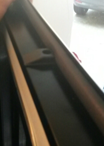

Postby booyah » Sun Aug 16, 2015 4:39 pm
Are these what you're talking about?

Re: Manufactured door is sticking in it's frame
Postby Dalorin » Sun Aug 16, 2015 6:36 pm
booyah wrote:Are these what you're talking about?
I'm not sure of your doors, however, that does appear similar to mine, yes. I would call the place you purchased them and ask if you should remove them.
It's deceptive because they look like they belong in the door. However, I was told to remove those tabs.
The manufacturer apologized for not telling me at the onset.

Postby booyah » Thu Aug 20, 2015 2:47 pm
so yeah, I touched one yesterday sideways, and it fell off. Was held on by a little putty. Pulled the rest and the doors open and close so easy its silly now.
Thanks, that will make life better
