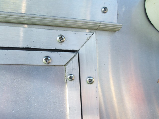

Postby Nobody » Wed Apr 29, 2015 8:25 am
Every screw used in construction of my TD was a 'round' head stainless screw of appropriate size (#6 or 8, 3/4" or 1" long). Even on the trim pieces which used a plastic insert I fastened the aluminum trim with stainless screws & then added the insert. When I added the 0.062" 'diamond tread' trim at bottom, I used #8 x 3/4" stainless every 3-4" or so. The stainless screws are much 'softer' than I expected & necessitated careful adjustment of the torque setting on my electric drill/screwdriver in order to prevent damage to the 'Phillips' screw heads... Even that was not always completely successful in preventing all damage :oops:

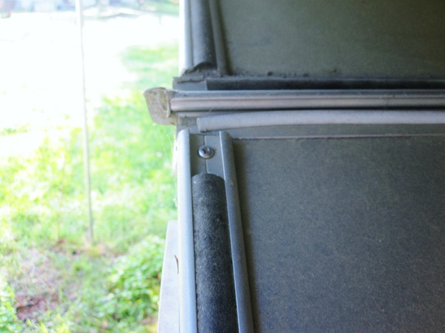

Postby woodywrkng » Wed Apr 29, 2015 12:54 pm
Stainless screws, and you could even hide them. The trim around my doors for instance is on the edges, rather than on the outside face. Caulk under the heads of course.
