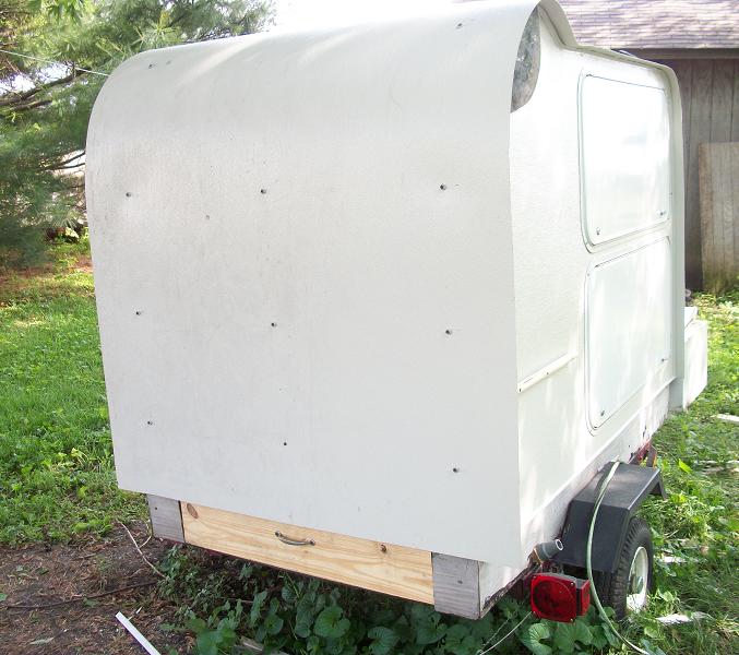

Postby Kaz » Sun May 10, 2015 6:27 pm
This what I've got for this summer.131544 :NC
