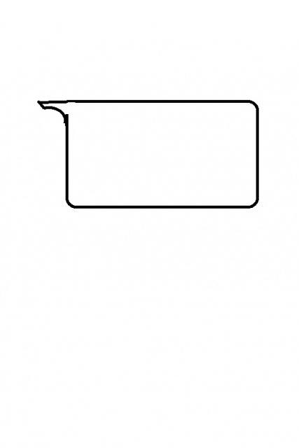

I spent this weekend in and out of the rain at a gathering. I want to go on record that my rear barn doors were left open in the rain a portion of that time. I am real glad I added the prow on the barn to help deflect the rain.
Maybe this profile will give you an idea........Image

Postby bobhenry » Tue May 19, 2015 6:31 am
I went looking for a better picture......Image
In this one you see the overlap at the top and the fact the door extends below the floor.
The strongback screwed in at the bottom to strengthen the door act as a water stop
and it also carries the weight of the door in transit as it rests tight to the floor.
The side rail strengthens the door vertically and seals against the side stud to prevent water invasion.
My thought was to install a rubber or expanded foam insulation seal but to date I have found it unnecessary.
