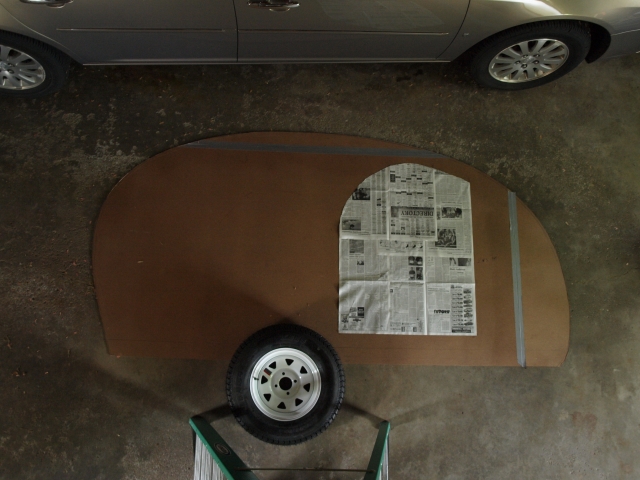

My first attempt at a door design. I have it laid out on my side template. Anyone see any glaring problems? I'm thinking the top edge will follow the contour of the roof until I hit the Generic TD design 18" radius. Do any of you artists know if a person can apply the Golden Mean to this sort of design. I mean, I am no designer, just want it to look good and function well without hitting my head on the frame constantly.
The axle will be 37" up from the rear of the 5x8 trailer bed. I can still move it back some if anybody sees that as a problem.

Um, isn't your template supposed to be the other way around. On a traditional TD the big bulge is in the front and the smaller tapering rear is in the, um... in the rear.
Aside from that "glaring problem" it looks okay to me.
On another note, door shape kind of depends on what type and configuration of door seal you plan to use; as well as the hinge style. For me, I'm doing an internal flange with collapsible bulb trim seal and lift off hinges, so the seal trim needs to be able to follow a minimum radius all the way around the inner door flange in order to have just one butt joint at the bottom. So I have at least a 6 inch radius in each corner. My seal configuration would not be as forgiving with the two miter corners you have on the hinge side (it looks like you plan to use a piano hinge?).
If you are doing T-molding with an external flange seal, then the mitered seals can work, but you have to have offset or strap style hinges so that the trim flap adjacent to the hinge moves away from the wall without binding. At least that is my impression I get from checking out other people's work who have used similar setups.

How thick is your ceiling going to be?
Remember to leave room for the door to miss the fender.

KC, I knew something wasn't right, just didn't know what. Staged that photo when I was extremely tired. Obviously rushed it. I don't have any idea how to approach the door weatherstripping or hinge. Right now just getting overall shape. I just took another look at my sandwich walls and it's back to the drawing board on construction method. Baby steps...
Roof will be ~2" thick. I'm about 4" off template edge on that door.

Here is a "corrected door" better view, although, I was on a ladder with flying blood suckers stabbing my legs and a flash that wouldn't cooperate. I ended up just holding the camera up over my head and missed the roof a bit.

Aesthetically I think the door would look better if you flipped it over, and had the top curve of the door follow the roofline.
But nobody seems to do that... so there must be a reason ? :thinking:
The hinges would be on the short side for it to open correctly, but shouldn't it work ?

I agree, it did look nice with the arcs matching.
Take no offense, but I'm not a big fan of a nice curvy organic shaped door with a big flat on one side detracting from the curves. It's just a mismatch thing IMO.
Also, re: having a short hinge side. My thinking, especially for a door with two separate hinges instead of a piano hinge, is that all of the force required to compress the seal will be transferred in a triangle between the door latch and the hinge(s), so to try and equalize the clamping force on the seal and avoid uneven forces trying to twist the door, it would be best to have the hinge(s) located as high up and down on the door with the latch located as close to the middle as the window will allow.
On the other hand, there are many people who have built with huge variation, so maybe it isn't that critical. Just saying. :D

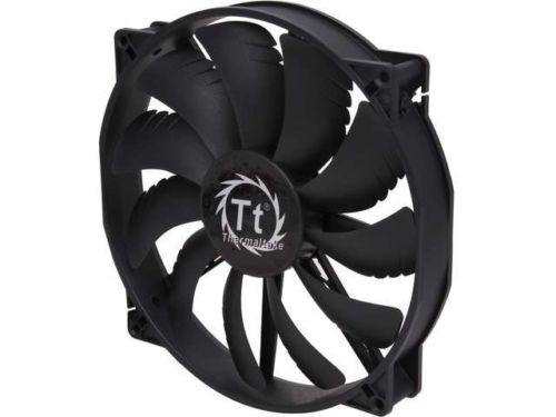

I indeed have been planning for ventilation. Below is the 200mm case fan I received and am quite happy with. I haven't worked out the details of how I am going to incorporate it just yet. My idea is to duct it through the galley cabinets down through the floor with a make-up air vent built into the front cabinet/tongue box. It is 130cfm and very quiet. It was only $14 shipped.
Kitecop, I agree, the door shape isn't too original or creative. I am going to research other shapes before I skin the walls. I'll have to stay with the general 30h x 36w size though.
