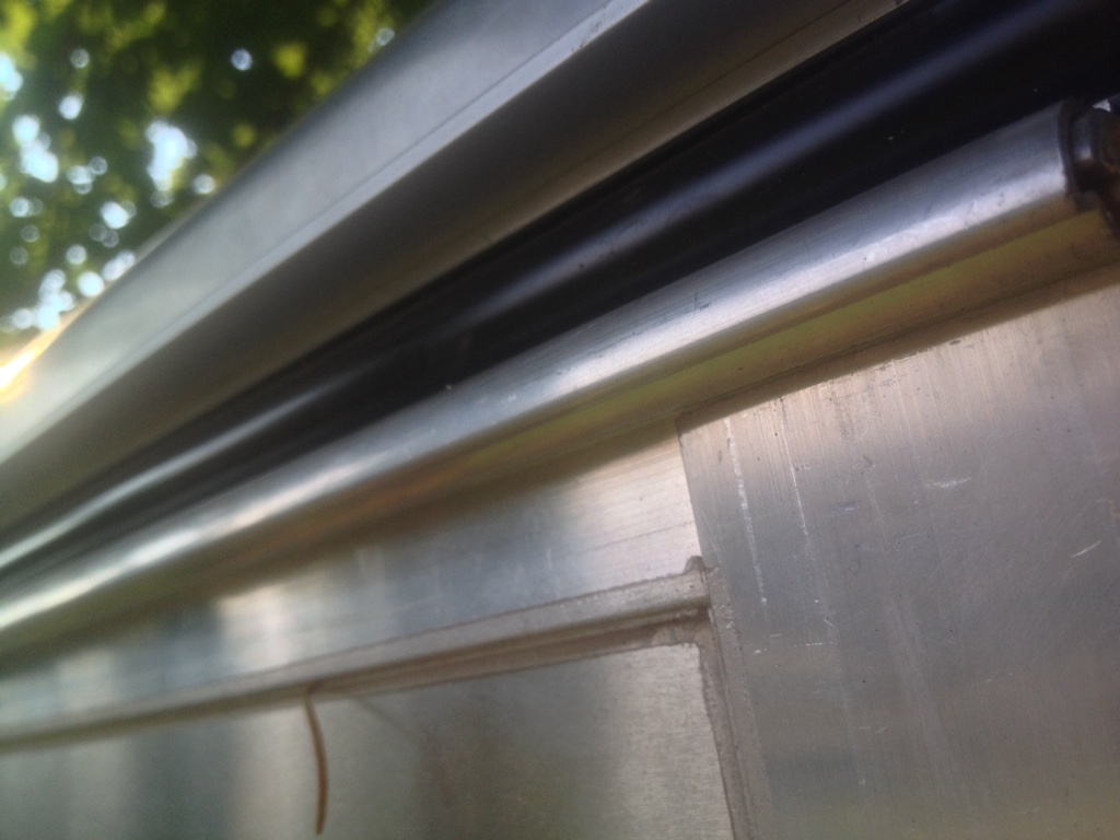

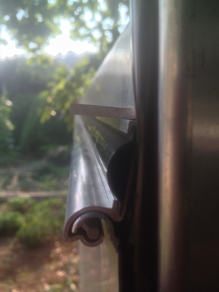

After buying a hurricane hinge because that should be leak proof, it leaks. Stupid me spends about $60 total, has to drill holes in the hinge and then stress out installing the flimsy thing. I feel like I should have bought a cheap piano hinge and covered it with rubber, my first thought. After I read this forum it seemed the better solution would be a hurricane hinge. The dew went right through the hinge as soon as I opened the hatc this morning. The hinge gets water in the joint between the two parts and capillary action pulls the water through. As it is now this hinge is worthless.

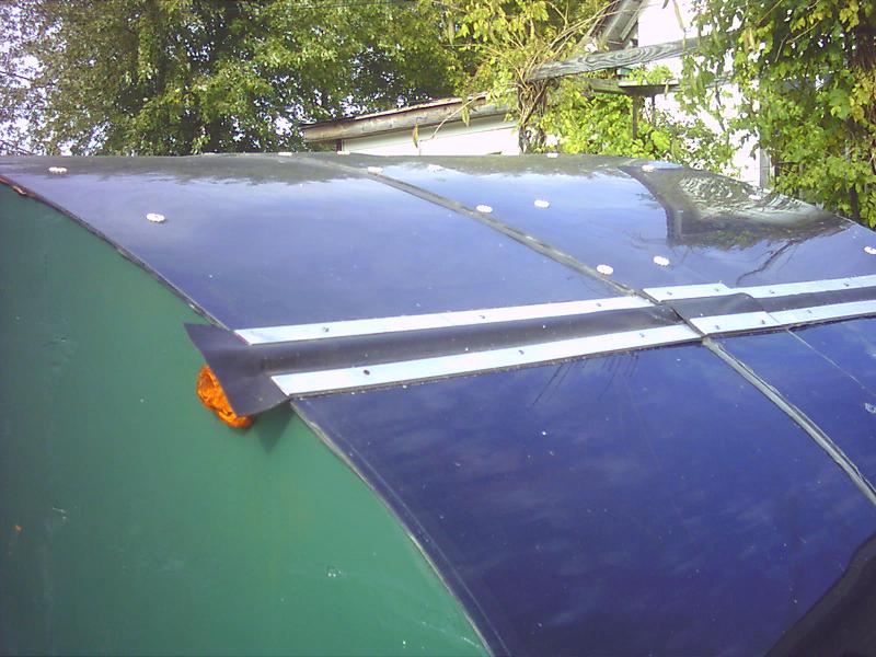

My Hurricane Hinge leaks too. I live in a windy place and when the rain is being driven directly on the rear of the trailer it comes right through the middle of the hinge. However mine was closed and sitting behind my garage when all this was happening. Took me a while to figure out what was happening because it didn't leak during every rain storm. If I spray a garden hose on the closed galley, water will blast right through the hinge. To look at the closed hinge you'd think this wasn't possible, but it happens. Oddly enough driving down the road in a driving rainstorm I typically wouldn't get a drop of water inside my galley. Just let the TD sit behind the garage all closed up and it would get wet in certain rain storms. My solution was Gorilla tape which is a glorified duct tape which I put lengthwise the entire length of the hinge. Water typically doesn't get through the tape. Doesn't look the best but it works without me having to mess anymore with the hinge. Since my TD is now stored in a garage, the water problem is pretty much a non issue. My hinge is the older style without the little wing on the opening part. I was kicking around buying one of these like you're showing in your picture, but since the newer hinge also has issues, I think I'll just stick to the tape. After all I built this thing to hunt out of not to have every body admiring my great workmanship which to be perfectly honest isn't all that good. But I am happy with the trailer and that's all that counts.

I think the leak is due to capillary action drawing water through the small clearance of the two hinge parts.
This sucks, it's raining now.
Leaks in the middle, not on the ends.

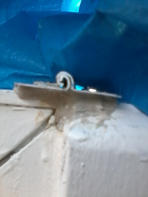

In the last picture with the blue tarp on top, which is the upper side of the hinge in your application, the left or the right? In that picture It looks to me like the uphill side of the hinge (what stays attached to the trailer when the lid is down in closed position, ought to be on the right.

The photo does look backwards but the hinge is installed properly. The hinge is on a flat surface parallel to the ground. The open side is to the rear, closed side front.
