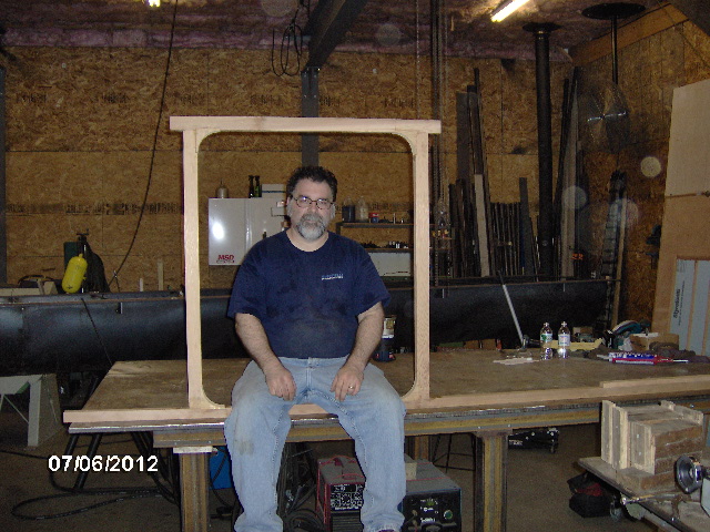

Here's the frame. I did have to add a couple more blocks for a few things I didn't think of at the time, but it's easy when doing this type of construction, as long as one side skin is still not in place. I did the build from the inside-out. One block was for coat hooks, another for 2 drink holders & another was in the galley, when I changed the upper cabinet & needed a bit more blocking for the screws into the face frame. There was one added for the rear corner brace on the outside galley shelf.
With the skeletonized frame out of 3/4" plywood & 1 side laminated with 1/8" plywood (baltic birch), it's 27#.
Mock-up for the wall to deck fit, frame & panel in place. This is before the doors & windows go in.
Add insulation & another skin & it's about 42# per side, an estimate since the assembly has started & I can't weigh a complete side at this point.
This construction isn't too heavy, has decent insulation & is very strong once both panels are glued in place. 3/4" plywood is about 1.9 pounds per square foot, 1/8" is about .44#. A 3/4" alder solid board is about 2# per square foot, red or white oak is about 4#.

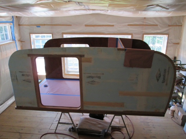

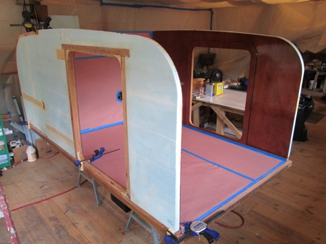

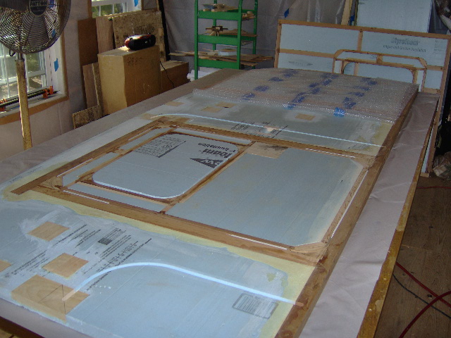

My walls are foamie hybrid construction consisting of a minimal frame; just a 2x2 cedar sill and door frame.
Along the edge of each galley wall I later grafted on a laminated hard edge made up of glued strips of fir slats, roughly equivalent to a bent 2x2 that ends just forward of the hatch hinge.
They are 9’-8” at the base and a little over 49 inches tall.
There are various points of 1x blocking let into the foam on the cabin side to screw cabinet frames, lights, light switches, coat hooks, etc., including a full height 1x4 at the bulkhead. Also various 1x blocks let into the outer face for fender mounting, porch light and side table. Here is the inside of the curbside wall just before covering with 5 mm Okoume marine ply, including the door which was shimmed in place and covered at the same time (similarly constructed using 1x2 cedar frame).
After skinning the inside, not including the inside of the galley yet, and before cutting out the door or the skin over the window opening, the whole assembly weighed 45 lbs.
Here are a couple of shots giving a little better perspective with the walls stood up after cutting the doors back out.
I could easily handle each wall by myself by grabbing it in the upper rear corner of the door opening and stabilizing with the other hand on the galley hard edge.

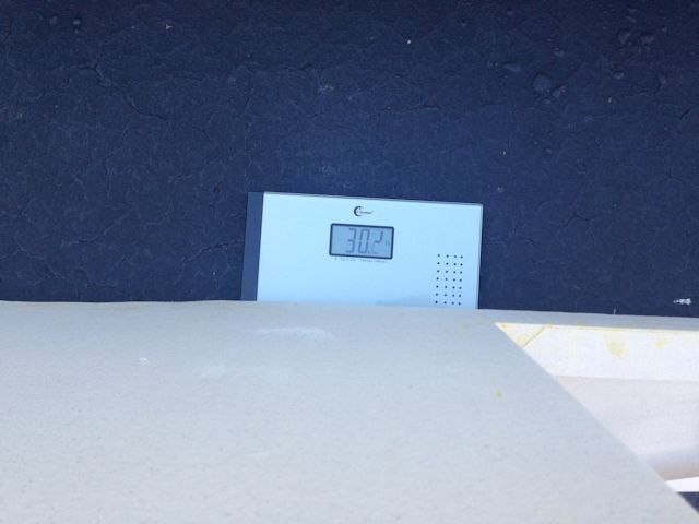

My wall is 30.2 pounds, that's with the hard edges, and the canvas glued on, on both sides!!! (no door)
