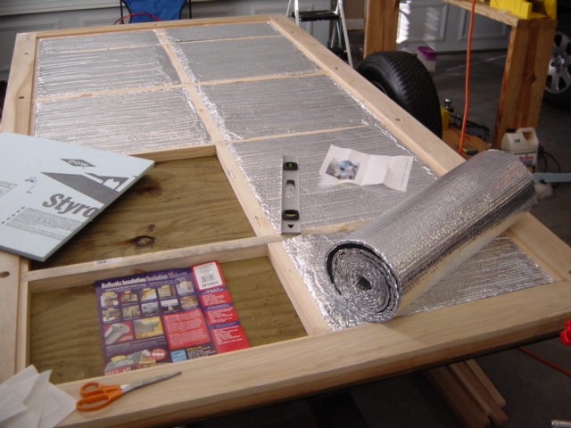

Postby jdjernigan » Sat Jan 07, 2006 10:53 pm
After reading the above, here is the bubble wrap I found at Lowes...
It's called Reflectrics? R value varies depending on application. In my floor, I used 2 sheets of Dow Styrofoam R-3 3/4"... Thought this would fill a 1.5" inch void....right? Well, it wasn't really not 3/4". I had 5/16" gap left to fill. The reflectrics did the trick.
I will plan to do the same with the walls. Note, I decided not to sandwich it between the panels...left on the interior... to help "reflect" the heat from within in the winter.
