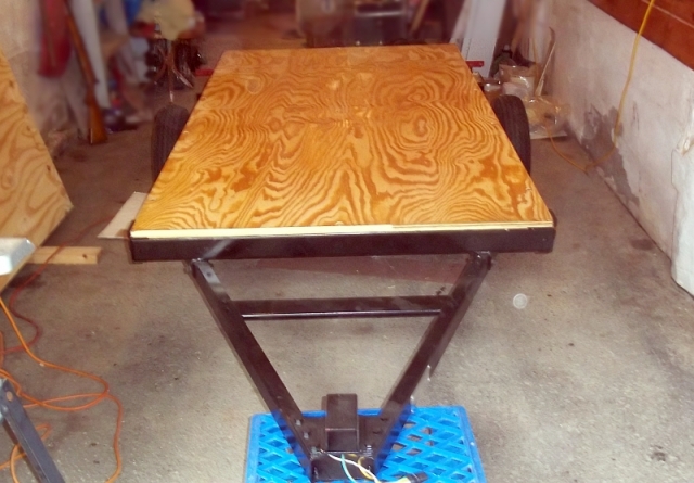

My daughter and I have started building a "Simple/Rimple" on a HF 4x8 trailer. (Build thread will be started soon)
I have 3/8" bolts which fit the existing holes nicely in the frame pieces for attaching the floor.
How many bolts is sufficient?
My current plan was to use two bolts per cross member (only one set in the middle) which is a total of 10 bolts.
These would have fender washers top and bottom to help distribute the load and a lock washer with the nut.
I also plan to use loctite.
I've seen lots of different techniques for mounting the floors, but not a discussion on how many bolts will do the job right.
The bolts are through a sandwich insulated floor, but the bolts themselves are through nothing but wood.
Thanks in advance for the advise and opinions.
