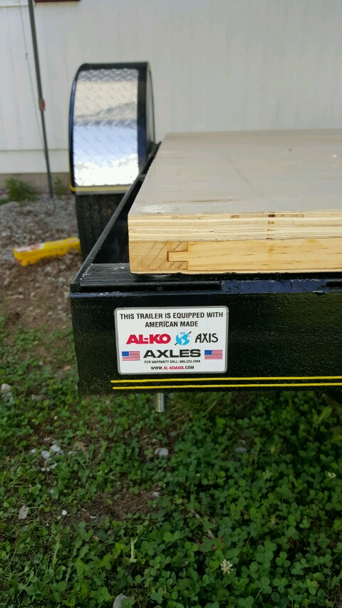

I've come into an interesting situation on my build.
The trailer has five pieces of angle iron making up the cross members down the length of the trailer.
From the back to the front I fastened the floor down with three bolts in each cross member (one bolt in the center). However, on the final/front most cross member it is made up of two pieces of angle so that its like square stock. I would need six or seven inch bolts to go all the way through.
Additionally, for whatever reason the trailer has a slight slope between the last two members resulting in it sitting a quarter inch or so below the floor. So even if I do bolt the floor to that last cross member it will pull it out of level.
I thought about using a shim but now I'm starting to wonder if I should even mess with it. Is there any reason not to leave it unbolted? I already have twelve 3/8 bolts on nylock nuts and washers covering 80% of the floor. It's not going anywhere.
Thoughts?
All input is appreciated
Dalorin

Postby dales133 » Wed Aug 19, 2015 4:24 pm
Id shim it and bolt it i think.
If youd planned on bolting it before id stick with the plan.
Dosnt sound like it would be to dificult and unsupported if you left it

Postby daveesl77 » Wed Aug 19, 2015 6:23 pm
A couple of ways is that you could do a drill through, with the bottom hole large enough for a socket to fit through, but upper hole the size of the bolt. You could then seal the bottom hole by welding a plate or not worrying about it. Another way would be to drill down through the top and depending on the thickness of the angle, simply tap the top part of the steel and use some locktite. Or, you could make a steel/aluminum wrap strap to go around the forward member and through bolt from floor to wrap. All those other bolts will keep it from lateral movement.

Postby mikeschn » Wed Aug 19, 2015 6:55 pm
12 bolts sounds like enough. But if it's necessary, I would shim it, and use self taping bolts...

Postby noseoil » Wed Aug 19, 2015 10:34 pm
I don't think the extra bolts will do anything to help at this point. If you already have 12 bolts in place, and the box is stiff due to side panels, roof & deck attachments, I think you'll be fine. Be flexible! 12 bolts is 58,000# of shear strength. Hopefully the build isn't over 25,000#, so your factor of safety is still 2:1....

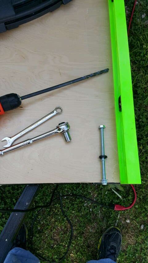

Postby Dalorin » Sun Aug 23, 2015 4:03 pm
All, thank you for your help. Attached is my final solution. I found six inch bolts and some spacers. I was able to attach the front while keeping the floor level.

Postby backstrap bandit » Sat Sep 26, 2015 7:46 am
I really don't think it's necessary to bolt it like u said u have plenty in there now however the gap that u have should be shimmed because eventually it will sag just from moisture and weight being applied to floor but all that is needed is a little rite bond or liquid nail and the shims and you should be good did I mention I have only 6 bolts holding my build down 3 in front and 3 in back and it's good no need to over kill
