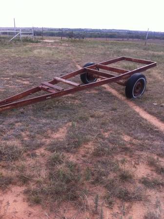

Bob - That is what I was thinking about, but modified a bit. Longer pieces of angle on each side. This would spread the support of the metal out further. 2 x 2 square tube tongue running the length of the trailer with the 2 pieces that form the "A" from just behind the coupler to the pieces on the side (where the axle hangers are). It would look like that pic, but on steroids. I have seen your posts where you have found great deals on trailers. Unfortunately, here in Oklahoma, people want retail $ for old used stuff. I did find a boat trailer at a decent price, but it was only 48" between the wheels. I want to go 7 ft wide, 6 1/2 at the minimum, 6 ft high on the inside and I don't want wheel wells in the trailer. I don't think I can build out far enough for the height to make it safe in a cross wind at that height. Here is a pic of that trailer. Not really sure how to load pics here, so hopefully this will work.

Boat Trailer.jpg (25.65 KiB) Viewed 878 times

I would agree that for most people, a wooden frame is something they shouldn't attempt. I can weld... sort of, but I would not be confident of what I built. (I haven't welded in 25 years, and even then, it was satellite dish mounts. I did make a hitch for a Pinto wagon to drag a Harbor Freight trailer with a dish on it. The car flipped - so did the trailer, but the hitch held. I wasn't there for all that fun). Quite honestly, the idea of building the wooden trailer is intriguing, but not in a "can it be done" kind of way. That attitude is what gets people hurt. Much like the fact that I know I can get 6 1/2-7 ft wide on the trailer I posted the picture of, but can it be done safely with a height of 6 ft? I don't think so. It is 16 ft long, so I know I can get 10 -12 ft in length. Your thoughts on using it? If my wife didn't sleep in a recliner and freak out (claustrophobia) when I had her climb into a Little Guy 5 Wide "to see what happens", I'd build a 5 x 9 on a HF trailer and be done with. Hmmm... little trailer or wife on vacation? Guess I'm gonna build a bigger trailer.
