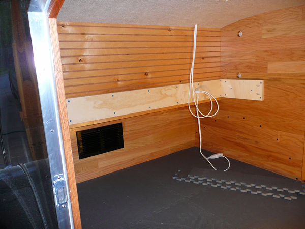

I build my galley cabinets in place. Below is a picture of the cleats that I used. The side cleats are screwed into 5/16" thick material. The bottom of the back cleat is fastened into 1/8" plywood and 3/4" framing. The top of the back cleat is fastened into 1/8" plywood only.
(If you do something like this, your cleats don't have to be that deep. An 1" to 1-1/2" would be sufficient. I had panels top and bottom of my cleats to form a space for cubby holes and a center drawer.)
This is a picture of my "shelf":

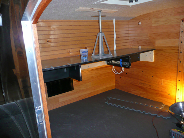

And here is the finished product:
