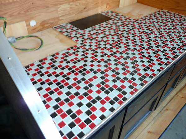

As KC said, I used tile on my galley counter. Instead of ceramic, I used glass mosaic tile. Instead of thin set, the tile is held to the 1/2" plywood counter using PL Premium construction adhesive. It is applied the same way as thin set with a notched trowel. For grout, I used epoxy grout. Everything has held up well. It does add considerable weight over a laminate surface though.

Tile after installation before upper cabinets;
Finished installation:

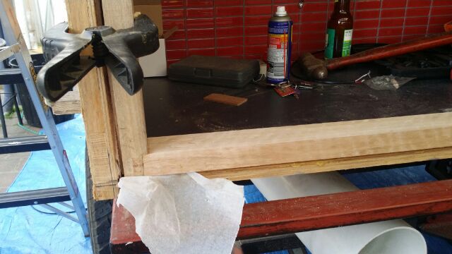

This is the best pic I have on hand but theres more in my build thread
