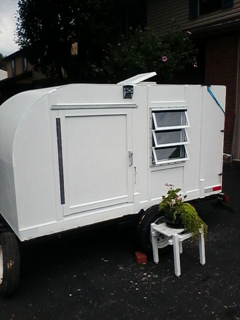

My exterior is thin, cheap underpayment from Lowes, less than 1/4". The roof has 3/4" ribs across with the same ply as a ceiling. There is Styrofoam as insulation and to make a weak sandwich. The side walls have battens to stiffen them where needed. Amazingly light weight and strong.
New Tom
Note battens framing door and window.
