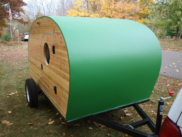

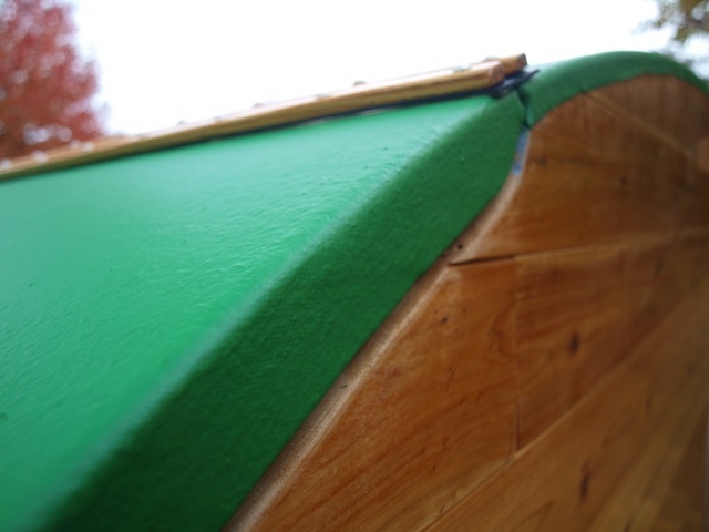

Postby TimC » Tue Oct 20, 2015 10:12 am
ukewarrior wrote:Tim,
Can you posts pictures of the final product?!!?
TimC wrote:Thanks for the responses folks. I am at four coats tonight. That's TBII under the canvas, one coat of exterior flat at about 80% paint to 20% water. Then another coat of flat at 80/20. Then two coats of satin slightly thinned. The weave is filling very well. If it were only warmer and drier here I would be making better time, but, time is all I have so all is well. supposed to be high 60s this weekend, yahoo! Hope to get my final finish color before Sunday and finish up.
The following show six coats, the final two being the finish color. It looked a little too bright for my taste under florescent lights, but, in the sun it is a little more subdued. Texture at six coats is just right. It is well protected and I like the show through of the canvas a bit.
Tim

Postby Talia62 » Tue Oct 20, 2015 10:32 am
That looks very nice! I like the slight texture still showing as well.

Postby ukewarrior » Tue Oct 20, 2015 7:51 pm
Thanks for posting Tim.
Very nicely done.
