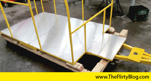

Postby alaska teardrop » Sat Oct 24, 2015 10:53 am
vegask wrote:Trying to figure out what I am going to use to build my floors and water proof them. Was wondering why people do not use a sheet of aluminum (0.03 or similar) to the under side of their floor instead of using roofing tar and other sealing methods? Or have people done this and I am just not looking hard enough?
I use aluminum attached to the steel frame (.050" minimum) overlaid with extruded polystyrene & a thin flooring. No wood flooring structure or tar. Some pictures & more information here: viewtopic.php?f=27&t=51991
