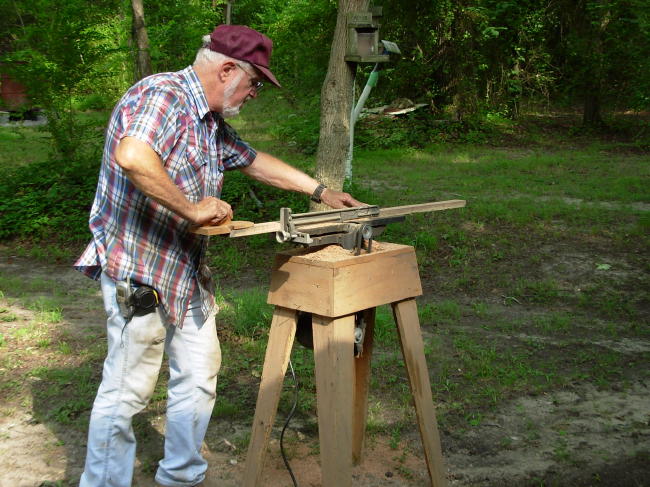

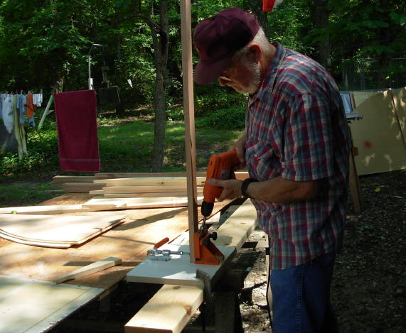

I'm pretty sure I wouldn't use any 'bowed' pieces of 1" bys (actual 3/4" thickness) for framework. You're asking quite a lot of the 1/4" ply to straighten a piece of 3/4" wood permanently, especially a short piece. When I built my TD in 2006 (60" outside width, 114" length of cabin overall, 46" high), I bought 1x6" & 1x12" spruce & ripped it to needed widths, discarding any knots, splits, etc. I also had some 1" by white pine from packing crates that I was able to salvage for framework use. Like Dales133 I assembled the framework directly on the 1/4" oak plywood inner wall using Titebond II glue & pocket screws. For the door(s) framing I used oak 1x3" pieces (cut from rough sawn oak boards that I 'ran' thru my small 4" jointer to attain the needed 3/4" thickness). I cut (ripped) my spars from spruce 2x4" (except for the galley hatch hinge connection pieces, again I used solid oak) using notched rabbet joints to attach them to the walls. My TD made its 'maiden voyage' in September 2006 & since then we've towed it more'n 25K miles. The walls are as flat & sturdy now as then, with no problems of any kind I can attribute to wall construction other than occasional 'oil canning' of the aluminum skin on especially hot days in direct sunlight, & that's a temporary thing. After using 3/4" foam insulation in all the 'voids' of the wall framework I 'skinned' the outer walls with 1/8" (I think) luan ply before adding the 0.040" aluminum skin. IMO using good quality framework material is important!
