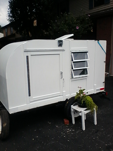

After all of the rain we've had lately I've recently discovered that the piano hinge used for my door is allowing water to get in behind it, then it will run down to the corner and end up getting wicked into my sheets. The rest of my home made door seal appears to be working just fine. So how on earth can I go about keeping water from getting behind the hinge? I thought about maybe some rubber behind it but I fear that will wither away and I won't be able to see it until it's so late and begins leaking again.

It's hard to help without seeing what you have now. Are you able to show us a picture of the inside and outside of your door to see what you have now?

This is the best I've got as of right now.

If you don't already have one, put a flange on the inside to channel any water that gets through your seal/hinge down and out. You'll need to cut holes in your seal or drill weep holes to let the water out. That seal won't keep all of the water out (think wind driven rain) so you'll need to come up with a system that takes care of what little gets through.
Don't forget about the surface tension of water. It will happily wick through any gap less than a 1/4" or so.

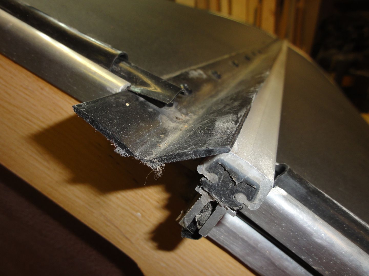

Bicycle inner tube materiel is not particularly UV friendly. I used a section of rubber roofing for our rear galley hinge.

Postby Woodbutcher » Tue Dec 08, 2015 10:01 pm
Had the trailer out today and took these pictures. That is a forever hinge used to divert the water up over the Galley hinge. It solved my leak. But it must extend past the body to work.
The first try was short because I didn't want to cut the RV edge molding and it let the water curl around and trickle in,
Closed position...
Galley open position. By just screwing one edge the other edge floats as the hinge moves.
