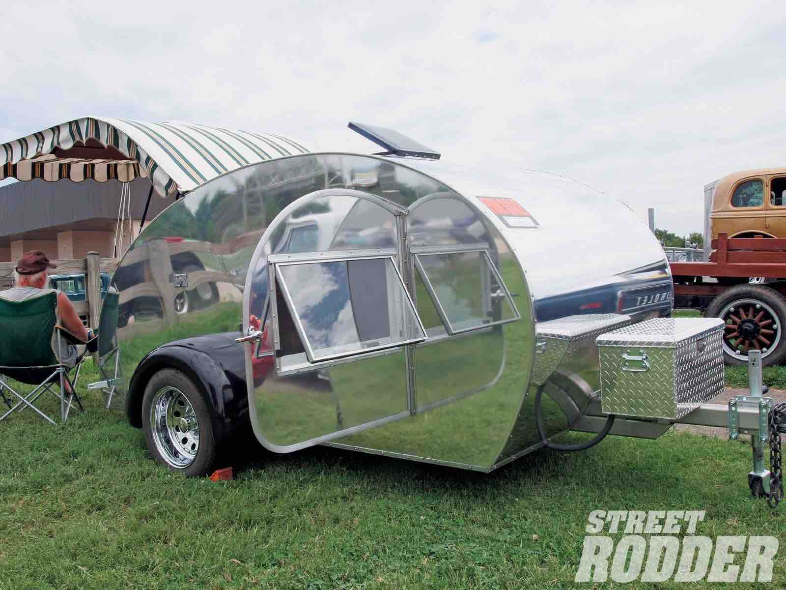

Hello everyone! This is my first post here, but I have been lurking around for a while. After saving up money for a while I am finally ready to make the jump and will be purchasing my first camper. By the end of spring I will have my very own custom built trailer. As much as I wanted to build one myself, I am not anyone near the skill level needed to complete this project in a timely manner and will be hiring someone to do this for me.
My perfect teardrop would have the exterior of the teardrop featured below (source unknown). The reason for my post is that I was looking for information on this type of aluminum that is reflective and shiny like that of an airstream. The teardrop will be kept in my garage when not in use and keeping it covered and shiny will not be a problem for me.
Does such a product exist and where can I purchase it?
What are the disadvantages of this type of aluminum versus the aluminum found at http://www.wrisco.com/aluminum-sheets/11.html. Does anyone know how much more it costs versus the other aluminum?
My understanding is that the airstreams use a thicker aluminum that is less prone to dents and scratches. Is this accurate?

The teardrop you are showing appears to be a mill finish and a lot of polishing to get it to look like it does.
Almost any aluminum sided teardrop could be polished that way if desired.
I've been there done that and will only use anodized aluminum, no more polishing.

I used bright clear anodized aluminum on my teardrop. It is reflective but is nowhere near as reflective as polished mill finish aluminum. The anodizing keeps it looking that way. (It doesn't have to be polished).
The aluminum cost about twice what I could have purchased mill finish aluminum - approximately $1000 for a 4' tall x 5' wide x 10' long teardrop.
