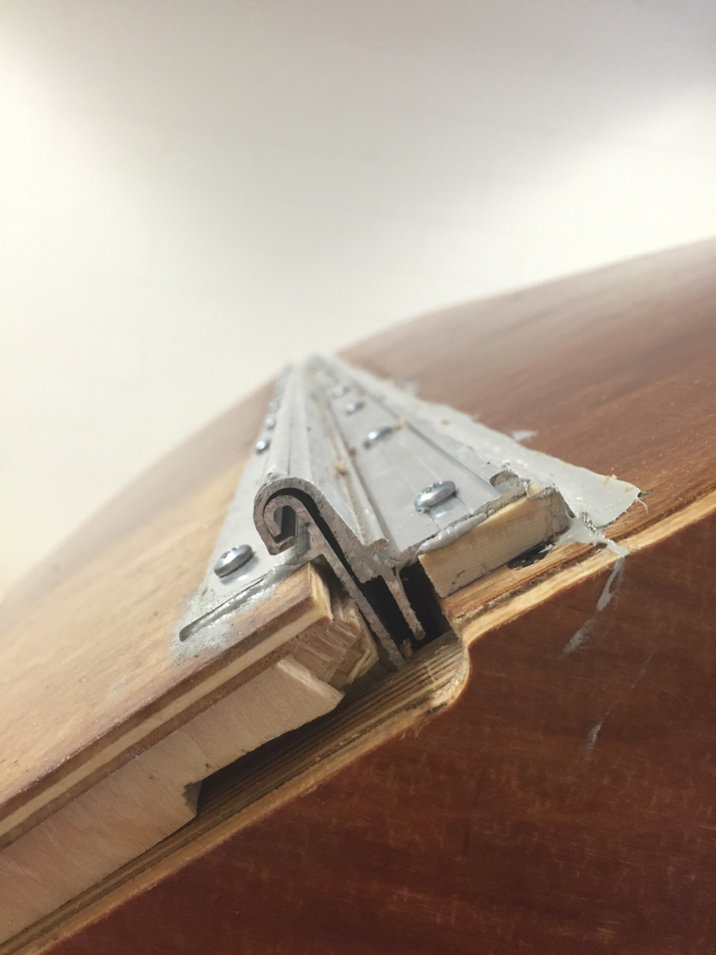

Postby hpuckett4 » Sun Dec 20, 2015 12:38 am
Okay team, this photo is pretty obvious about what is wrong, but basically I wasn't able to let the hinge run beyond the edge of the galley, leaving a big gap for water. I also had to put a spacer in to help the gap. I've still got a while before I'm done with the rest of the teardrop, but I'd like to find the best way to seal the ends here
I would really like to avoid running a big ugly piece of rubber or plastic the whole way across the seam, but I've seen it done that way. I'm also told there is a way to cap the end, but not sure how to do that while still allowing it to pivot. I'd like to be as descrete as possible, while still being practical. Could I do the pond liner thing just on the 1 inch at the ends?

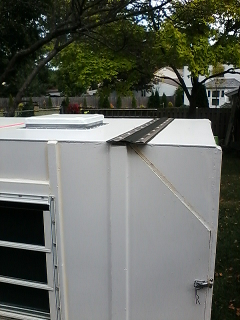

I just had a look at your build journal and it is great to see a student taking on a project like this. I am sure you are looking forward to going camping in the spring.
I debated with myself about ordering a hurricane hinge and ended up going with some experienced hinges from an old closet door. I sealed it up similar to what Bob did. Actually I remember looking at his pictures for inspiration. I used strips of walnut above and below the hinges and for the seal used a bike tire tube. It does need to flew quite a bit when the hatch opens and closes so a fairly flexible seal is desirable. I left the rubber overhanging at the end. A more flexible material allowed be to make the hinge cover narrower. I don't think there is any hinge that would look great with a woody, but this is simple, cheap and if you look at the pictures below I don't think it destroys the look too bad, ie- it isn't the first thing you notice when looking at the trailer.
The first trip I took with the teardrop, I just covered the hinges with clear tarp tape. It worked pretty good too.
138307 138308
By the way - when repacking those trailer bearing be sure not to make the mistake I did long ago. The bearings need a tiny bit of play in them. Otherwise they will heat and expand slightly, then heat and expand some more and then overheat and disintegrate or even melt the axle. The proper procedure is to tighten with a torque wrench, then back off and re-tighten finger tight, then back off to next cotter hole position. I like to use the ez-lube type hub covers with the grease nipple on them and never take the bearing apart again.

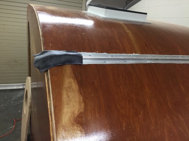

Postby hpuckett4 » Tue Dec 22, 2015 11:35 am
This is just a prototype, but my trim would overlap this bicycle tube,basically acting as a rubber umbrella, thoughts?
hpuckett4
Posts: 49
Joined: Wed Aug 26, 2015 5:09 pm
Re: Another hurricane hinge problem
Postby drhill » Tue Dec 22, 2015 10:37 pm
Yes, that is pretty much what I did and it is working well. Keep the trim small to be aesthetically pleasing. You can get a better look at mine if you click on the pictures. I never have sorted out how to post decent size pictures. Anyway, I finished the wood first and then installed the inner tube rubber and wood trim using a good quality clear silicon.

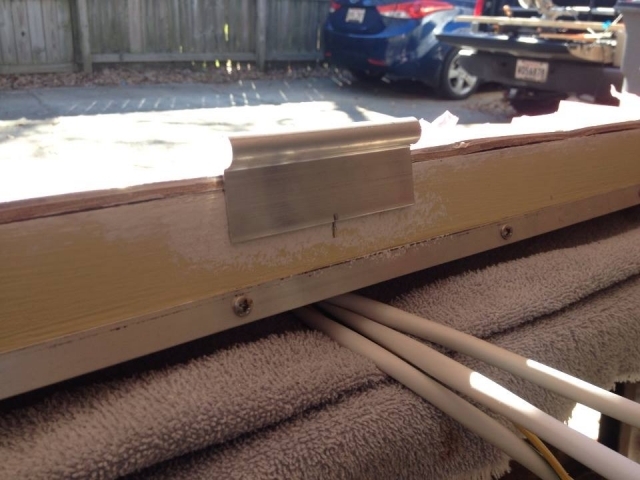

I deliberately cut my hurricane hinge flush with the sides, and then added this little piece of aluminum as an end cap. It's caulked and screwed on of course. The two holes are to allow water to drain off the top. The trailer has been outside for three years now without a leak.
However, I think you cut yours too short to do what I did. You may be best off to just buy another hinge and either let it stick out a ways, or cut it flush and make the plate like I did.

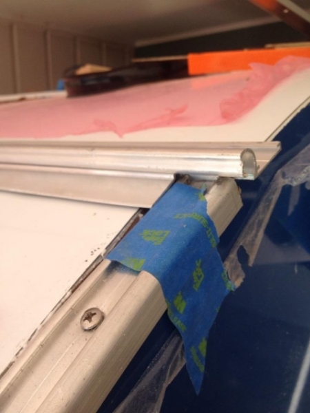

Sometimes a fellow must sacrifice looks for function. A rubber strip over the hinge is your best and most economical way out of your dilemma. What many see as good looks I see as awful design because it doesn't work.
A friend gave me a roll of 12" wide synthetic rubber for roofs. I cut it to 6" lengthwise and long enough to over lap the sides. I used an aluminum 8' flooring transition strip cut in half to secure the front and back of the rubber strip.
I used 3/4" #6 screws with finish washers to hold down the aluminum strips. Finish washers are hollow so I filled the bottom with Mortite rope caulk. The non hardening caulk squeezed out and made a totally waterproof seal for the wood and screw threads.
Mortite rope caulk is like modeling clay. It is good for sealing up anything that may be removed later, maybe years later. Rope caulk is great to seal up unusual gaps and holes because it is quick and easy to use. If you're having problems with the gap at the hatch hinge you can throw in a ball of non hardening caulk and close the hatch. It will smash and conform.
