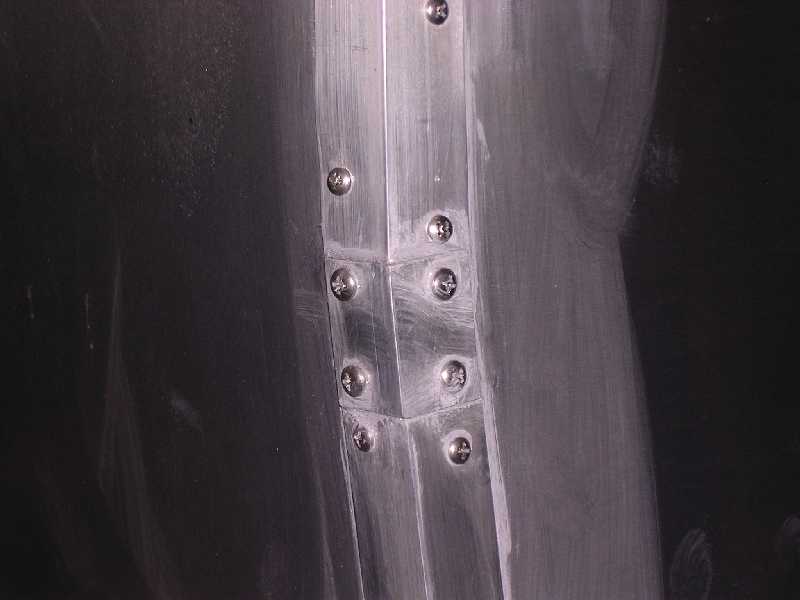

I bought 8' lengths at Lowes and spliced it.. it worked out nicely. And much less expensive too.
I seamed it at the lower front of the teardrop. I butted the joint, then applied a 2" section over top if the seam. I used plenty of polyurethane to insure a good joint. I am pleased with the result.
Here is a closeup. I still need to clean it up.
