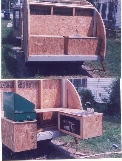

I use a "layout stick" which is the same width as the cabinets. A length of 1X2 with pencil marks is your friend when making cabinets. If the stick fits in the opening & the cabinet fits the stick, it will always be the right size. A full size cabinet pattern (cardboard & a pencil) is the best way to see how things fit together.
Here was my "blueprint" for the galley. Best of luck!
Cabinets are roughed-in and set in place
Finishing the details & stuff

Galley's are like snowflakes, no two are alike, unless you buy a manufactured one. I find it easier to get all the dimensions of the things going in the galley and layout where to put things. I do like noseoil and draw it up.
